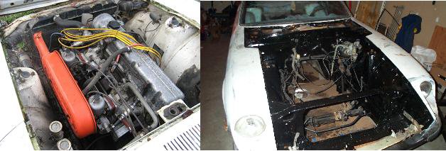

240zBoy Posted January 24, 2010 Author Share Posted January 24, 2010 Motor/ Transmission is out and sold. Time to get a nice coat of por-15 on the engine bay. I am using this stuff quite a lot but I just love the finish and protection it offers. Especially on the frame rails and battery tray. Will have pictures up for everyone when thats all done. Finally feel like I am making some progress. Quote Link to comment Share on other sites More sharing options...
