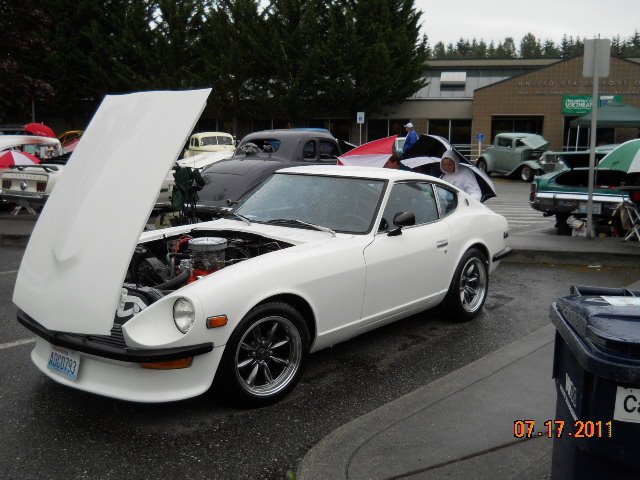

240zBoy Posted July 7, 2011 Author Share Posted July 7, 2011 Just about done with the reassembly Quote Link to comment Share on other sites More sharing options...

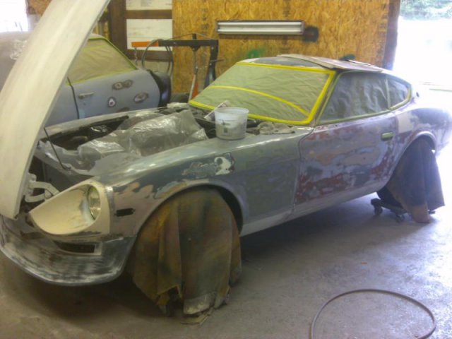

240zBoy Posted July 18, 2011 Author Share Posted July 18, 2011 Looking pretty and brought her to my first show ever yesterday Quote Link to comment Share on other sites More sharing options...

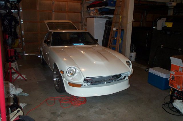

240zBoy Posted August 1, 2011 Author Share Posted August 1, 2011 Got a knock and ended up spinning a rod bearing or two and messing up the crank. Rebuild time. Going to throw in a big cam while I am at it, high flow oil pump, fix 5th gear and maybe grab some better flowing heads. Of course I got to get my crank re-grinded and see if rods are reusable ughhhh this sucks. Quote Link to comment Share on other sites More sharing options...

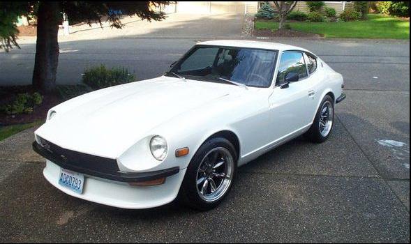

240zBoy Posted June 15, 2012 Author Share Posted June 15, 2012 (edited) Haven't updated this in a long time haha. Rod knock was much more severe then thought and resulted in getting the cylinders bored and a new crank. Along with it I got it decked and the motor hot tanked. Threw in a big cam that is made by CNC or something like that. Read up on it and its kind of a mystery cam but I like it. Thought it was going to be to big but it still turned over and has a beautiful sound. So now it's a 355 with hyperteuctic pistons. In addition, overheating was what caused my engine failure so I got an aluminum radiator with a big summit racing fan and built myself a custom shroud out of alluminum. Is doing a nice job. To be really safe I am also wrapping my headers when I attempt to get the exhaust a little higher in a couple weeks. Anyways I got to fixing fifth gear as a clip backed off fifth gear. Have better interior pieces on the way to. She is leaking a little oil and tranny fluid so a family friend is going to fix that while I am finishing up my summer school session at college. Good news is, the motor is a monster and I love it. This is a photo someone took from the show I attended before leaving for school. Edited June 15, 2012 by 240zBoy Quote Link to comment Share on other sites More sharing options...
Chunky Posted June 21, 2012 Share Posted June 21, 2012 Awesome work guy! I like the way your car turned out, simple and clean. I'm shooting for a similar build on mine. I recently got a set of 16x8's as well. Still working out tire sizes, may I ask what size you're running in the pics above? I like the way the car sits. Quote Link to comment Share on other sites More sharing options...
240zBoy Posted June 30, 2012 Author Share Posted June 30, 2012 (edited) Yea I am at a college summer session right now but I will pm you when I get back. Thanks for the compliment, they worked out great, I did put longer studs and a spacer on the fronts because the fronts just pairly kissed my toyota brakes. Could have took a grinder to the brakes a bit if I wanted to but figured I shouldn't. I actually have 2 extra spacers and 2 sets of the longer quest studs somewhere at home because I didn't put them on the back. I did have to use a dremel to get the spacers to fit flush. Let me know if your interested. Update: Toreit open with a family friend last weekend on his lift to check out the rear main. It was a brand new seal we put in but it failed. Just a cheap product I guess. Went out and bought a metal/rubber $20 rear main seal and siliconed the piss out of it. Dry as a bone as of now. Tranny also needed to be resealed along the shifter. WOOHOO! Fully opened it up when I was driving home and it is so much faster than before! Time for the exhaust when I get back! Edited June 30, 2012 by 240zBoy Quote Link to comment Share on other sites More sharing options...
