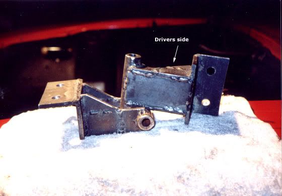

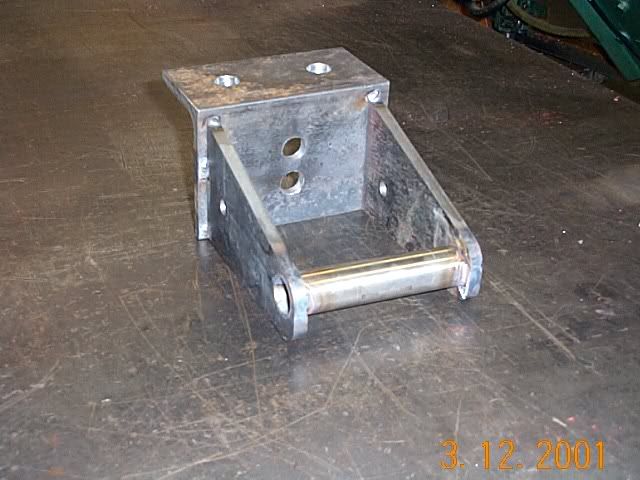

Beau M Posted July 10, 2009 Share Posted July 10, 2009 So while searching I cam across Dave's website, www.V8-240Z.com. I found pictured of motor mounts that look to be fairly easy to fabricate, like these: My question is what kind of mount do I need on the engine block? Is that custom also? Quote Link to comment Share on other sites More sharing options...
7MGFORCE Posted July 10, 2009 Share Posted July 10, 2009 Looks like it uses the 65-72 motor mounts. I used a 68 mustang mounts on mine that I got on eBay looks just like the one in your picture. Quote Link to comment Share on other sites More sharing options...
