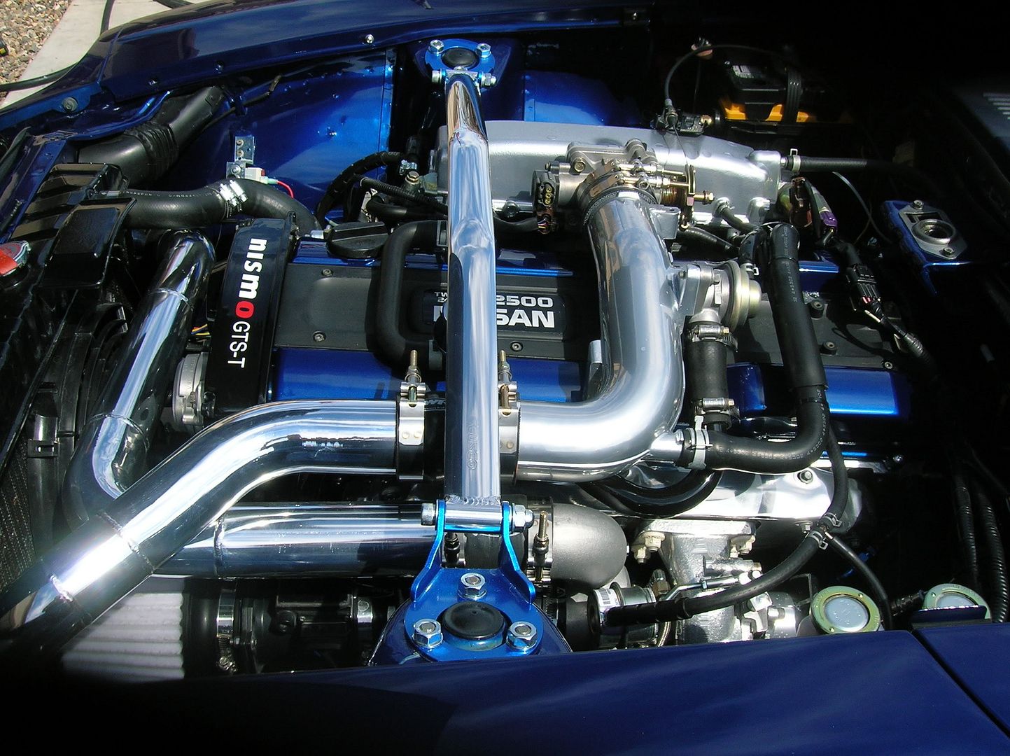

jakeoster Posted October 12, 2009 Share Posted October 12, 2009 I got an RB25 with the stock plenum in a 75' 280z and was wondering if there is a strut tower brace on the market that will clear the crossover pipe. Can provide pictures and measurements if necessary. I am using McKinney's Mount kit. Quote Link to comment Share on other sites More sharing options...
Midnight-280Z Posted October 12, 2009 Share Posted October 12, 2009 Here you go. Cusco Strut Bar with the stock intake mani. the car is a 73 240Z though, but it should be the same. MSA sells an exact copy but in carbon fiber if you want. Hope this helps...As a lot of people have previously stated, the stock manifold is the main issue. 1 Quote Link to comment Share on other sites More sharing options...
jakeoster Posted October 12, 2009 Author Share Posted October 12, 2009 Awesome just the answer I was looking for. Appreciate it. Quote Link to comment Share on other sites More sharing options...
