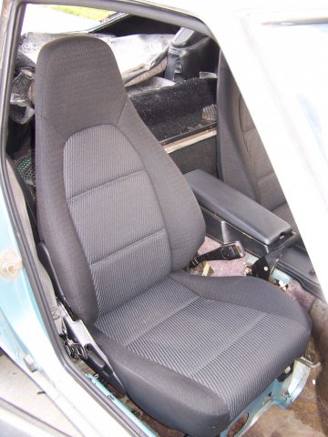

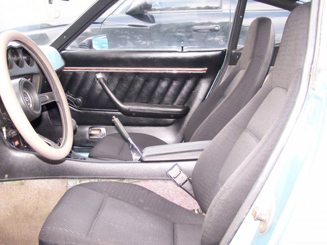

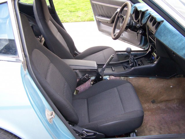

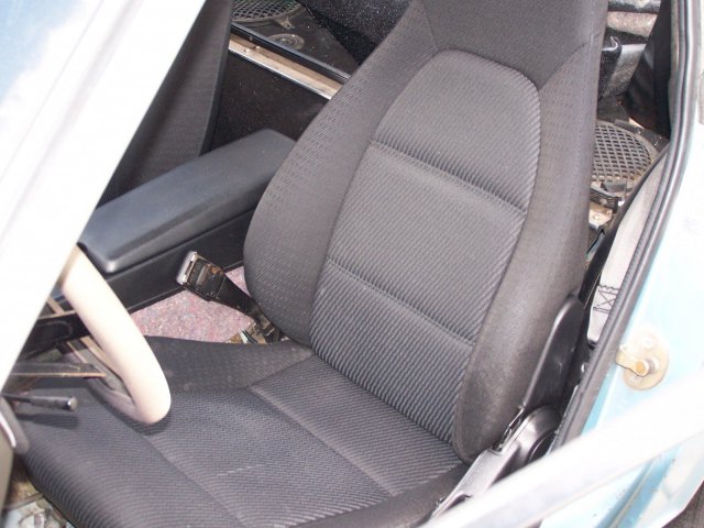

I picked up some '04 Miata seats from a forum member yesterday and put them in last night. He had them previously in a 260 with stock rails. The seat rails are different from a 280 where the rear mounts, so I swapped out the 280 rails and they fit like they were supposed to be there. I'm 6'1" and no headroom problems even with a helmet on. Here's a few pics.
