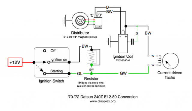

I am seeing this more and more lately. I dont know if this applies to you, but you cannot just remove the stock ballast resistor, you have to make a jumper to bypass it, otherwise, the ignition will only get power during the "start" phase. Hope this helps.cool.gif

The wiring chart below might help. Dtsnlvrs is right, in your current setup you probably get power only via the start position of the ignition key, so the engine dies as soon as the key is back to ignition.
