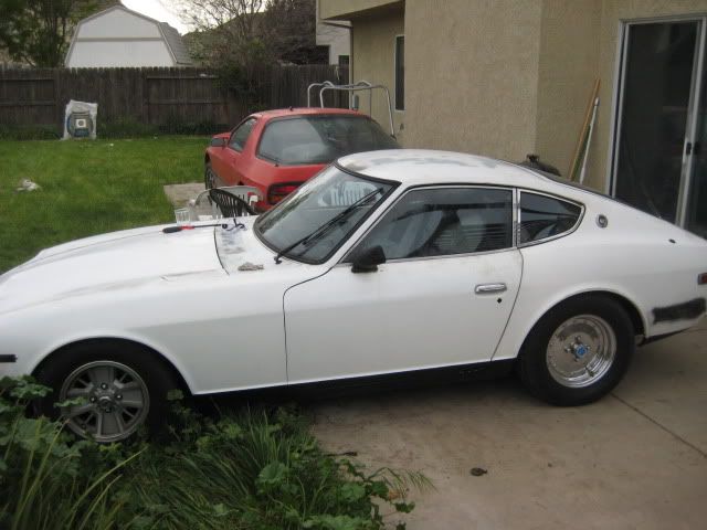

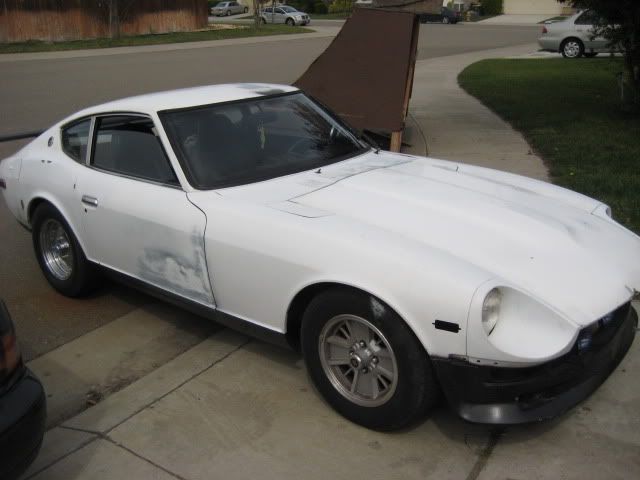

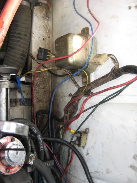

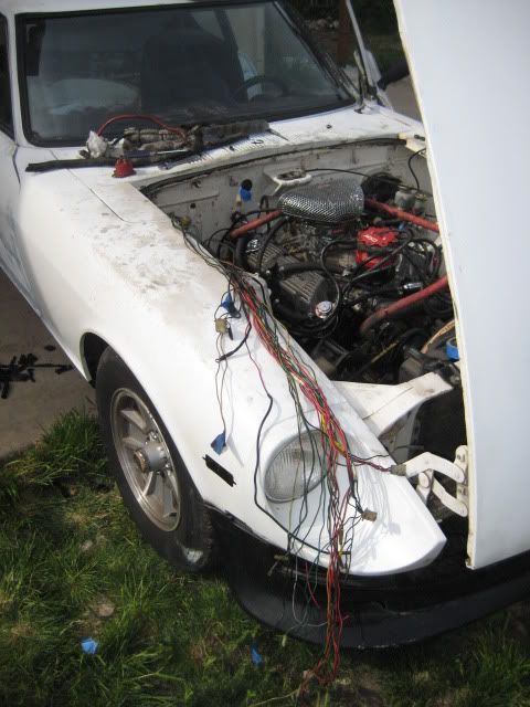

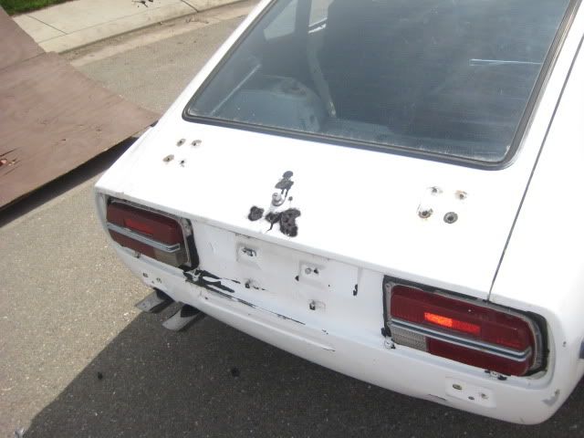

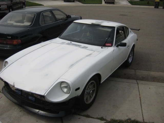

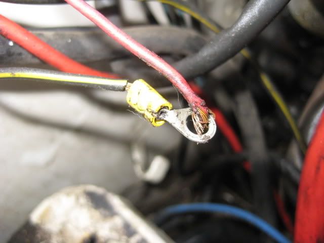

akaryrye Posted March 23, 2010 Share Posted March 23, 2010 Well, I Picked the car up for $2200 and drove it home a few days ago. As purchased, There were a few issues. Some ghetto wiring, crappy paint, exhaust rattling against the frame, passenger seat trashed, and some of the gauges arent working, including the speedometer and coolant gauge (yes i drove it home that way ). Luckily it was a cold night and a huge radiator sits where the stock one used to be ... heater was full blast the entire time as well. Even worse, the check valve for the brakes was installed the wrong way, making braking a scary thing until I figured out how hard i needed to push to get it to stop. Its got some issues for sure, but it did make the 200 mile trip home, and with around a third of the tank left. Supposedly the motor is a 302 with a block from a 74 and heads from a 68. It has an MSD ignition which I know very little about and an Edelbrock 1407 Carburetor. There is a very nice custom radiator setup with an electric fan. Suspension is definitely aftermarket as the car rides fairly low and I can see an aftermarket sway in the front. Tires are fairly new and there are cragers in the back which look sweet. My plans for the car are to eventually make it a streetable race car. Something I can take to the track or autocross on the weekends and drive to work if I want to. My short term goals are to strip the interior down to the metal, fix any rust, and lay down some POR 15. So far, I have found some rust, but I don't think any has gone all the way through yet. Getting the carbs in tune, Cleaning up the electronics and getting working gauges is also high up on the list. Seats, roll bar + door bars, and better brakes will come next. Beyond that ... flares and wide rubber, better camber/caster/toe adjustability? One thing at a time. Anyway, some pictures of the car that I have taken so far. Exterior Pictures (note the **** wing is removed and will be on craigslist) Interior Pics, taken post-gutting. Most panels are present, but I probably wont reinstall many. I like the look of the exposed shock towers also. Engine pictures Quote Link to comment Share on other sites More sharing options...

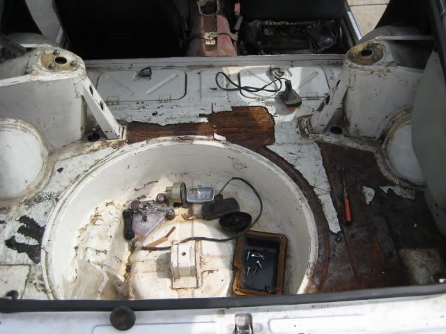

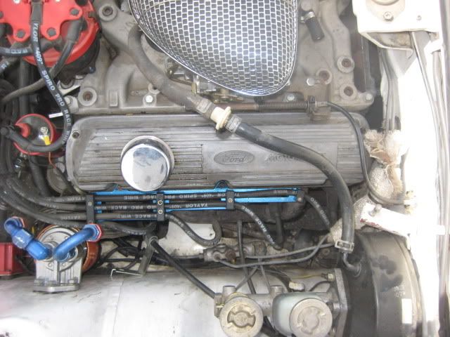

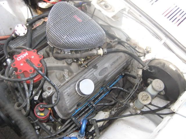

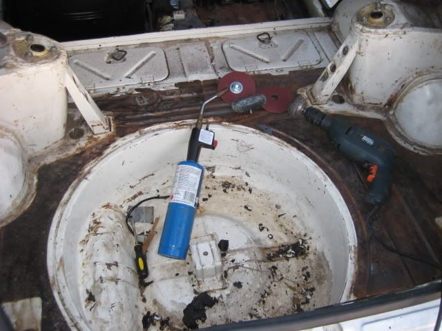

akaryrye Posted March 30, 2010 Author Share Posted March 30, 2010 Well I spent some time working on the car this past weekend. Most of my work involved compression testing the motor, continuing to strip the interior down to the metal, and electrical work. Bad news is that the motor has low compression in two cylinders and wet compression test tells me it is the rings. So, looks like I will be doing a rebuild. Good news is that I discovered the motor has 4v heads. I like the idea of having a fresh motor and knowing exactly what parts are in there anyway. Spring break is coming up and during that time, I want to rewire the car (the extent to which is yet undetermined), finish stripping the paint off of the metal in preparation for a sealing primer, and redo the exhaust with patriot shorties and 2.5" piping. Dont know if it is all possible, but I will be spending lots of time on it. A megasquirt efi system is also on the mind. Stripping interior more, next week I will be armed with dry ice and aircraft stripper. New window regulators on both sides, now they go up and down! hmm, signal converter + sell autometer or autometer tach that doesnt match but is more precise ... the cheapskate in me says keep em stock, i dunno. Rats nest: What the hell are those gold boxes on the drivers side wheel well? Ok ... seriously wtf man? that is not how you wire anything ever ... EVER! Wiring harness unbundled, more garbage. Here is how I left her until next weekend. This is my friends shortened subaru legacy lol. It runs beautifully, but it does not have a radiator hooked up right now so it only gets run for short periods of time. It was built to be basically a 4wd sandrail, but now it just sits and collects rust. This day, it was used to tow a chevy nova and an rx7 which did not run into the back yard. (pics are not me btw) Quote Link to comment Share on other sites More sharing options...

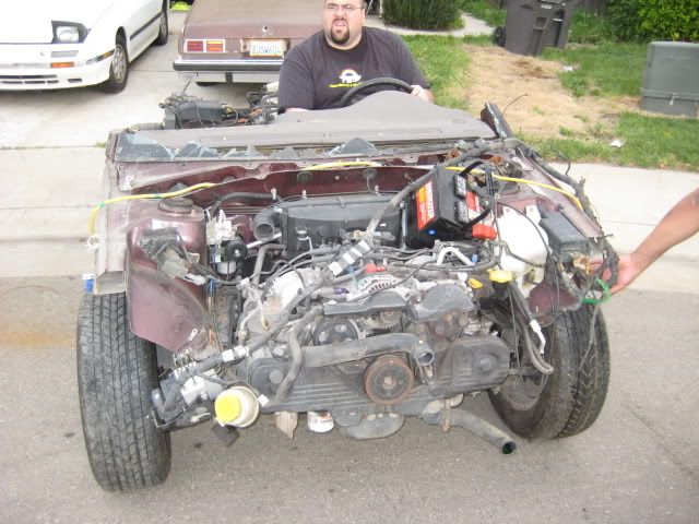

V8INtheZ Posted April 4, 2010 Share Posted April 4, 2010 Wow, looks like that thing has a pretty violent launch! Im curious to see what the engine has done to it, since I have a very similar car. Quote Link to comment Share on other sites More sharing options...

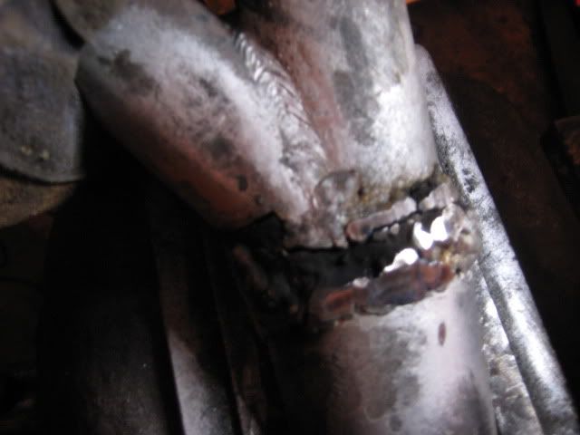

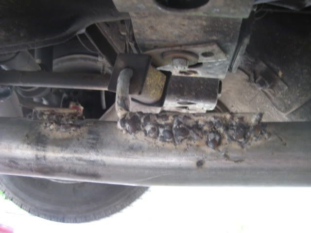

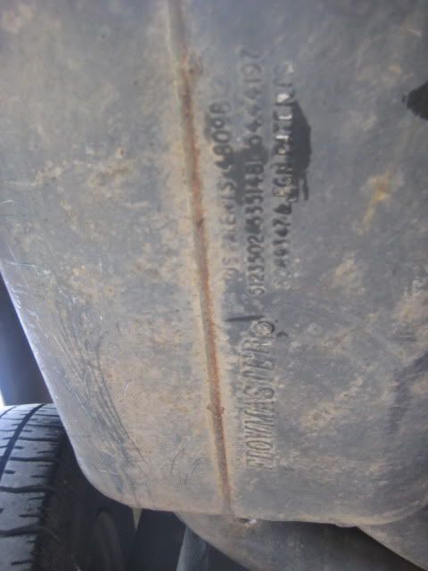

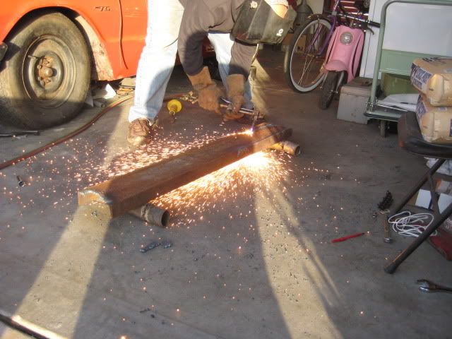

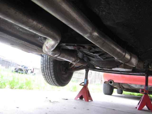

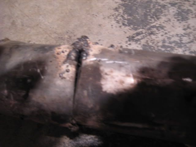

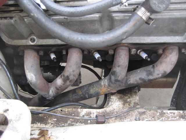

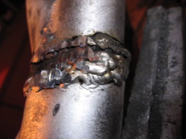

akaryrye Posted April 14, 2010 Author Share Posted April 14, 2010 (edited) Been working on the car some more. The exhaust was a basket case, so I redid it with patriot truck hugger headers and 2.5" piping and mandrel bends (sorry no pics because I was in the zone). Exhaust pics show what came on the car complete with headers cracked in multiple locations, terrible welds, and sections left unwelded which left gaping holes for exhaust to leak out. This necessitated a new transmission mount with reliefs for the exhaust (again no pics yet). BTW, firesaw is a baddass tool. Some wiring work as well with relays for the headlights also. Anyway the pictures I took are below: Edited April 14, 2010 by akaryrye Quote Link to comment Share on other sites More sharing options...

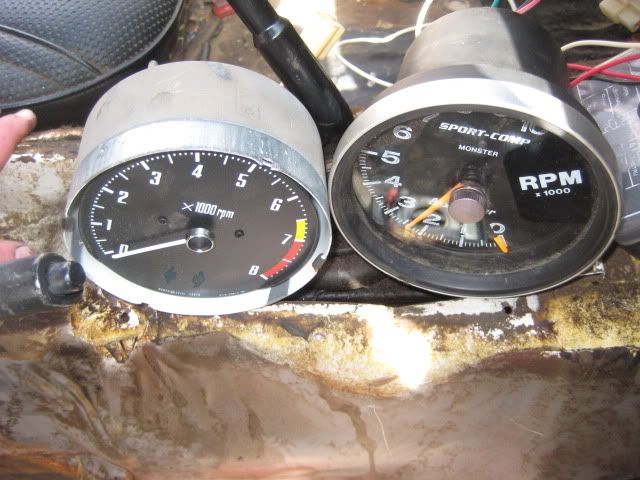

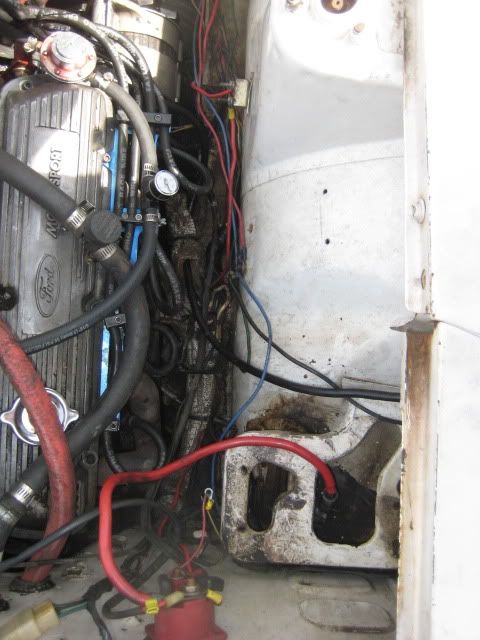

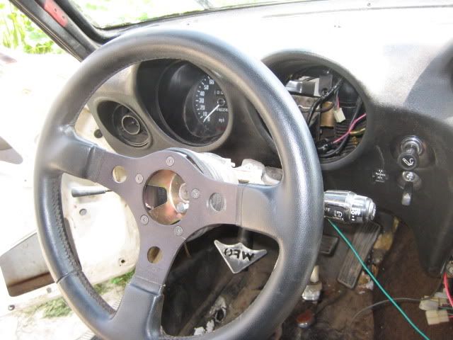

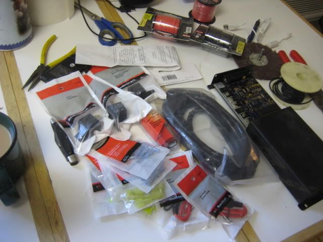

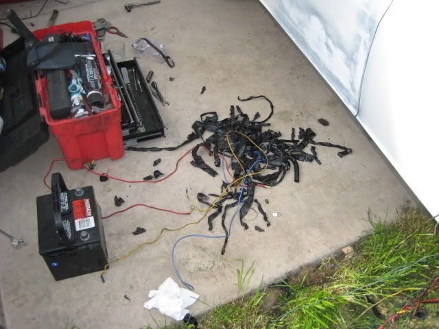

akaryrye Posted April 19, 2010 Author Share Posted April 19, 2010 it sounded cool i guess, if not a bit too loud. I am finally almost done with the new exhaust and headers and I hope it will sound a lot quieter though. I think some of the mean sound was created by massive exhaust leaks. Anyway, sorry I have been slacking on pictures, but I have been working. I removed all unnecessary engine bay wiring now, installed all new gauges (oil temp, pressure, clt temp) and mounted the tach in the factory location. I got the interior lights working, wired the headlights through relays and beefy wires, and cleaned up the engine bay by shortening the heater hose, fuel lines, etc. Finished the exhaust, aside from a header primary tube which I am modifying to get steering rack clearance. Quote Link to comment Share on other sites More sharing options...
akaryrye Posted May 9, 2010 Author Share Posted May 9, 2010 (edited) Well, last weekend I finally got it off of the jackstands and ready to fire up. At this point I have rebuilt the exhaust, made a new tranny mount, redid the engine bay wiring by removing unnecessary wires and adding some new wire as well, and installed new gauges and sensors and a few other this and that sort of thing ... but when I went to start it, the engine backfired out the exhaust and caught the filter on fire I forgot to mark the distributor when I took it off, and I am eyeballing it from my pictures above. Shouldn't that be close enough? OTOH, it wasn't the easiest to start up as it was so maybe a little bit off means no start? A little help would be welcome Oh, also what should I set base timing to once I get it started? I have a 4 bolt v-belt pulley and I am not quite sure what the timing mark indicates. I suppose I could always find TDC with a rod of some sort in the plug hole. Edited May 9, 2010 by akaryrye Quote Link to comment Share on other sites More sharing options...
