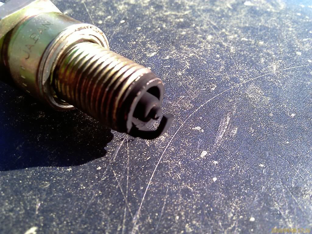

Car seems to run obscenely rich. Plugs are black as night.
