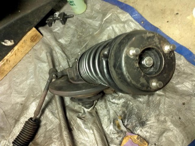

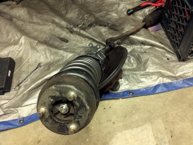

I was wondering if anyone can help me here. I just purchased some Eibach Progressive springs and KYB's GR's. The front assembly is on the floor. I installed the struts into the sleeves no problem. Then I put the springs in, no problem. I used the springs with 001 number. I called up the Z store to find out on what side is up, they said that it didn't matter. Attached is some pictures of my situation. These coils have a little bow in it. Is this normal or did I get the wrong struts......help
