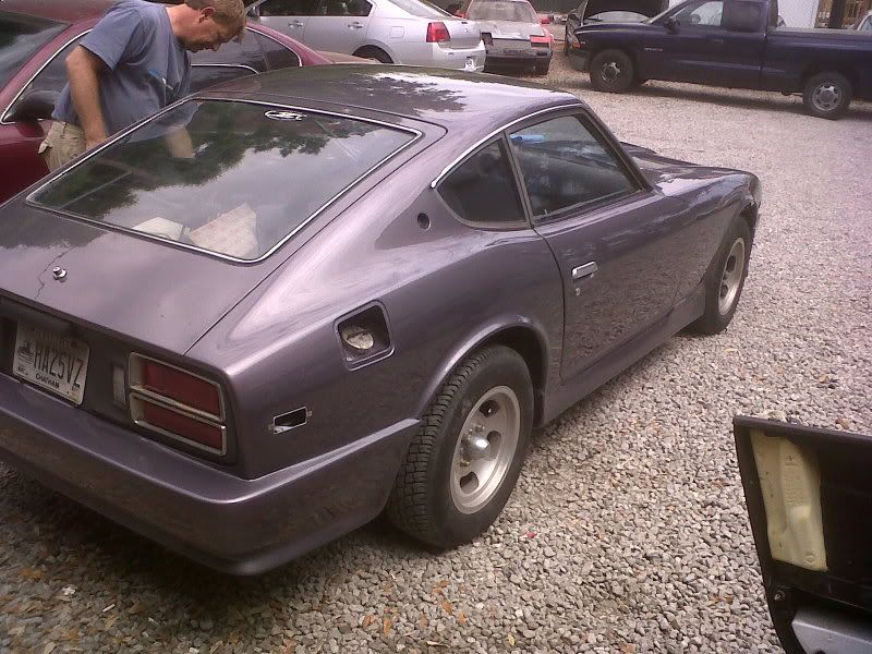

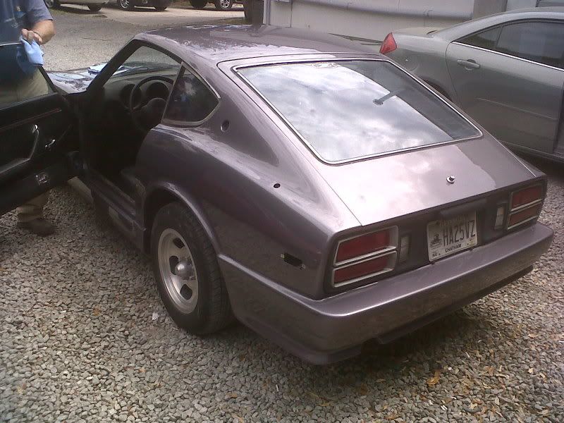

PR280z Posted April 22, 2010 Share Posted April 22, 2010 Nice job!Thanks for the material list. I like the color, now what`s that color code again? Is it the 370z charcoal grey? Quote Link to comment Share on other sites More sharing options...
