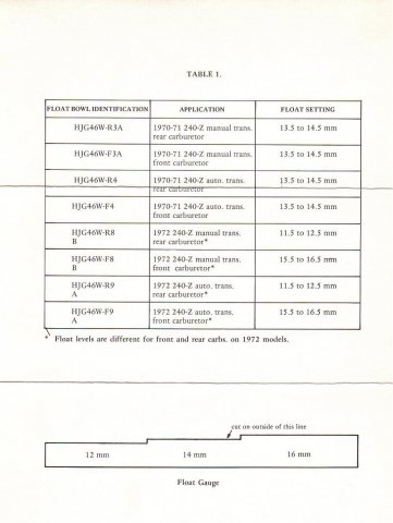

No specifications in kits. No info in FSM on front vs rear carbs. The float bowls front to rear are different, but have the same specs :o .

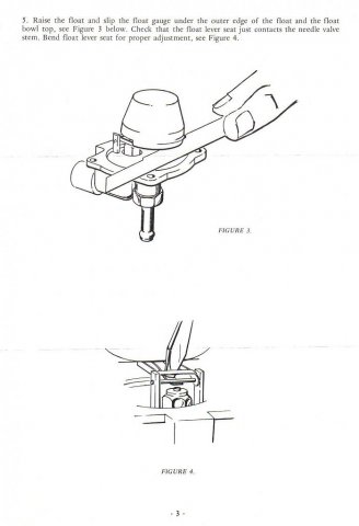

So after more SEARCHING, I found the info buried in posts on Classic Z Car.
If you have SU's, this is a must see!!!
SPECIAL NOTE: FRONT FLOAT SETTING DIFFERENT THAN REAR on '72 carbs!!
