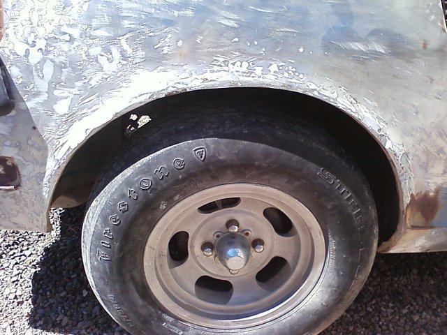

Under the bondo and surface rust i found the quarter panel to be in better shape than i had anticipated. I'm not entirely sure what to do with it though. I know that I want to put ZG's on it eventually, so I don't know if it would be best to buy a quarter replacement, make my own fender to bolt the flair onto, or just cut out the rust and place a flair on. The dogleg is rusted out, so that will need to be replaced, but overall I'm not too sure where to start here.

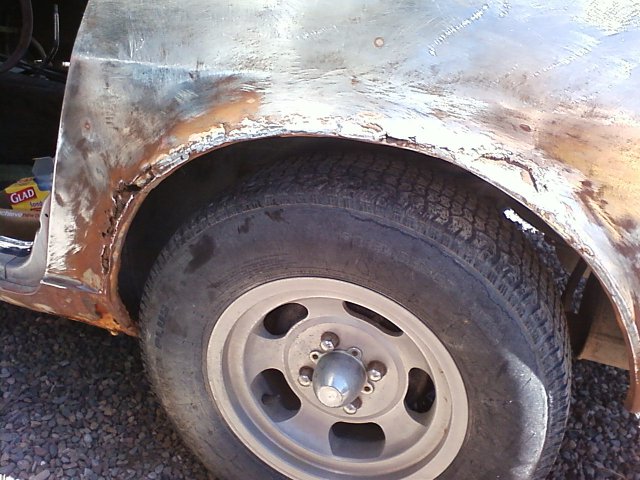

Same with this side, it isn't as bad, as it was protected through the years with an inch coat of bondo, but still not sure what my best option would be.

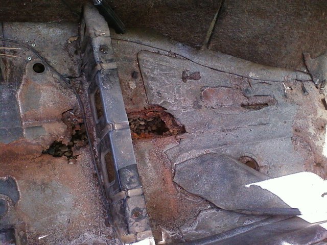

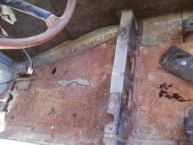

Floors are shot, big surprise there. I'll be getting new pans, just not sure where from though. Anyone have a preference between Zedd Findings and MSA's floor pans?
