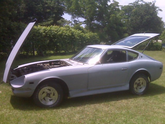

jenzos Posted May 23, 2010 Share Posted May 23, 2010 (edited) Well I had that '78 280 and it ended up being an epic fail, the only good thing it had was the interior. I saved that and found a '76 with alot less rust, still rust but not nearly as much. This one runs and drives. Frame rails are good, the only real bad spots are the rear quarters on the bottom and the floor pan. Where else should i be looking? The engine bay is pretty good. the hatch is pretty good, a little rust in the spare tire well. Edited May 23, 2010 by jenzos Quote Link to comment Share on other sites More sharing options...
Geking Posted May 25, 2010 Share Posted May 25, 2010 Where else should i be looking? According to the 'How to restore your Datsun Z car' "anywhere metal" The cowing box, behind that side effect/running board at the bottom of the fender, the inside bottom quarter panel where the muffler sits, the 2 little cross bar tabs on the floorpan frame rail, go ahead and give a good pull on them, most times they rip off, the corners of the motor bay TC rod frame rail, where they end at the rear of the motor bay. I do the old screwdriver stab trick, just get under the car and stab away with a screwdriver, just hard enough that it does not dent the metal. The undercoating hides lots of thin/compromised metal. Good luck on this one, no obvious rust in the picture. Quote Link to comment Share on other sites More sharing options...

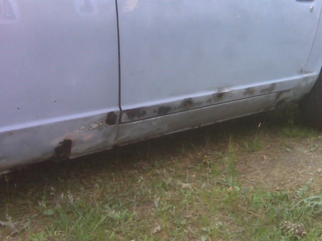

jenzos Posted May 30, 2010 Author Share Posted May 30, 2010 (edited) Look what i found today!! Oh well. I think i am just going to cut it out and put the sideskirts on to cover it for now... Edited May 30, 2010 by jenzos Quote Link to comment Share on other sites More sharing options...
