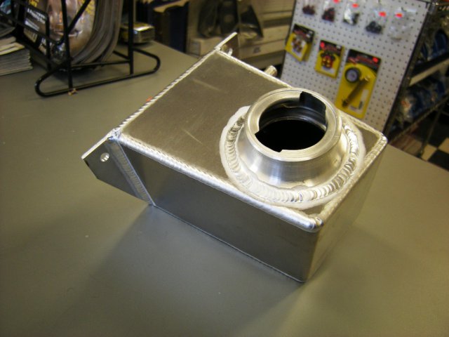

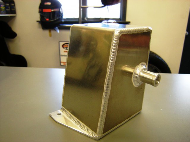

This is a little project I did at work. We were putting a 2006 6.1L Hemi drivetrain into a '49 Plymouth and needed some custom reservoirs. It's 1/8" 3003 welded with 4043 and I made the fittings from 6061. The inlet is baffled and I also pressure tested it to 20psi. Machine is a Dynasty 300.
