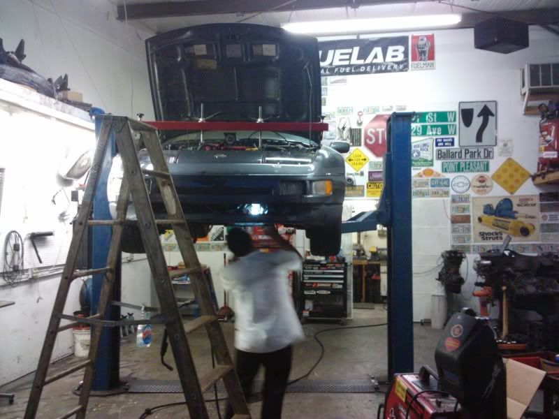

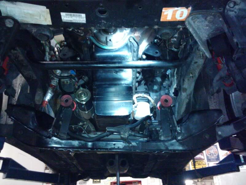

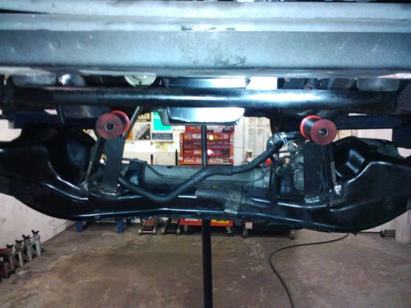

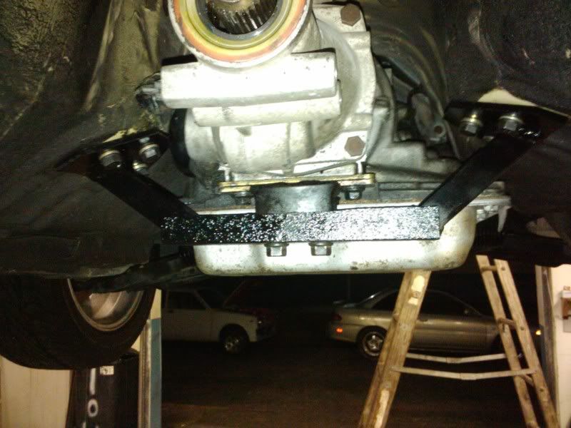

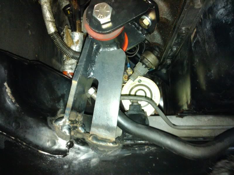

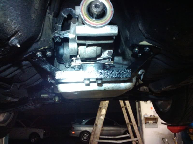

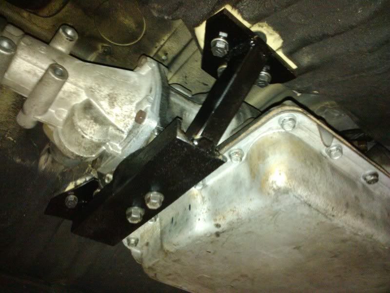

Well I finally got around to mounting the engine in with those mounts I got, and made a custom crossmember. Had some help from my buddy Danny who's pretty handy with a welder. So I brought it up to his shop to finish that and some other welding details. Heres some pics.

Also got my driveshaft done from a local place that does em, they ordered a special rear yolk that bolts and centers on the Nissan rear end, and uses a GM standard U-joint.

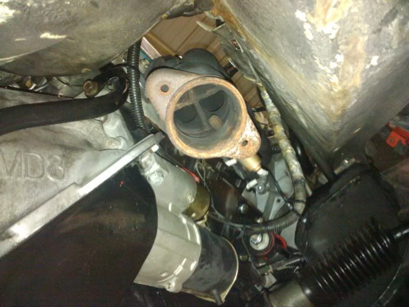

Header on the right side is from the firebird, im still playing with the drivers one to get it to fit between the oil filter and steering rack.
