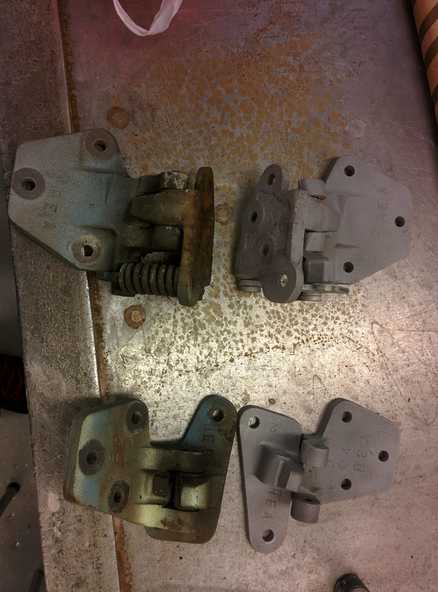

Hinges removed, disassembled and aluminium oxide blasted. Next powder coat and reassemble with new taps, bushings and grease. I also had to make new hinge detent roller for the other hinge beacuse the original was in peaces.
