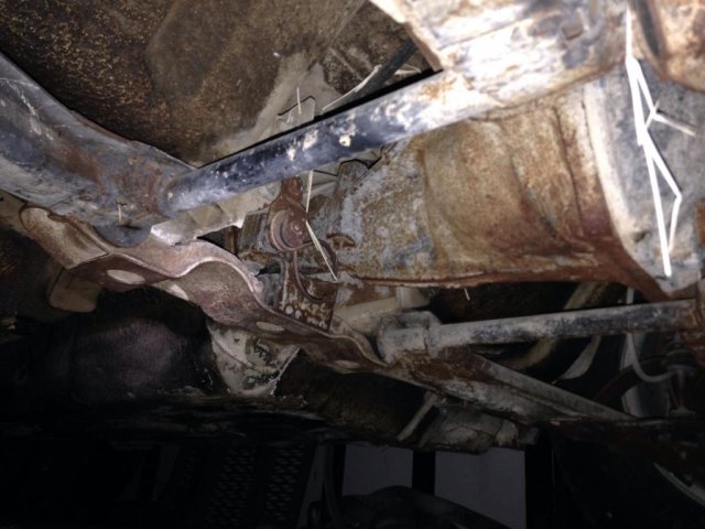

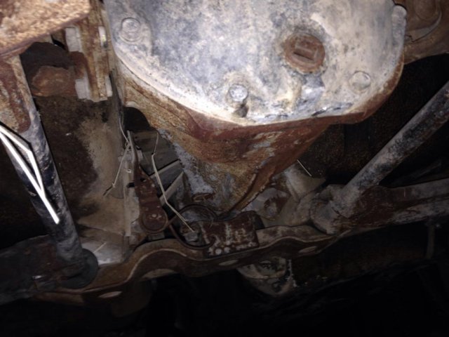

It looked like an r200 to me as well, I'm just not familiar with these cars yet. It does have a Datsun Comp LSD. The ratio is 3.545 from an auto trans car. That part was documented in the logbook, but the diff was simply referred to as a "big case diff" so I was unsure if it was a later r180 or an r200. This diff was installed in 1984. -

Anybody recognize what diff this is off the top of their head? Sorry the pictures aren't very good. I've done a little bit of googling but the diffs look pretty similar from the bottom. -

So, I looked up the part number of the companion flanges and they came up as 86 300zx. Is there any reason you would use those with the r180 k or would that indicate that the diff is likely an r200? -
