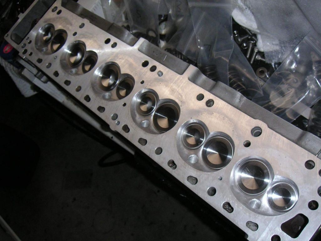

MONZTER
welded up and re-shaped N-42 head 36cc with stainless undercut valves @10.7:1 on top of flat top L-24 pistons +.015 out with .050 head gasket. Pump gas and no knock. total advance down to 29 degrees, super fast burn
