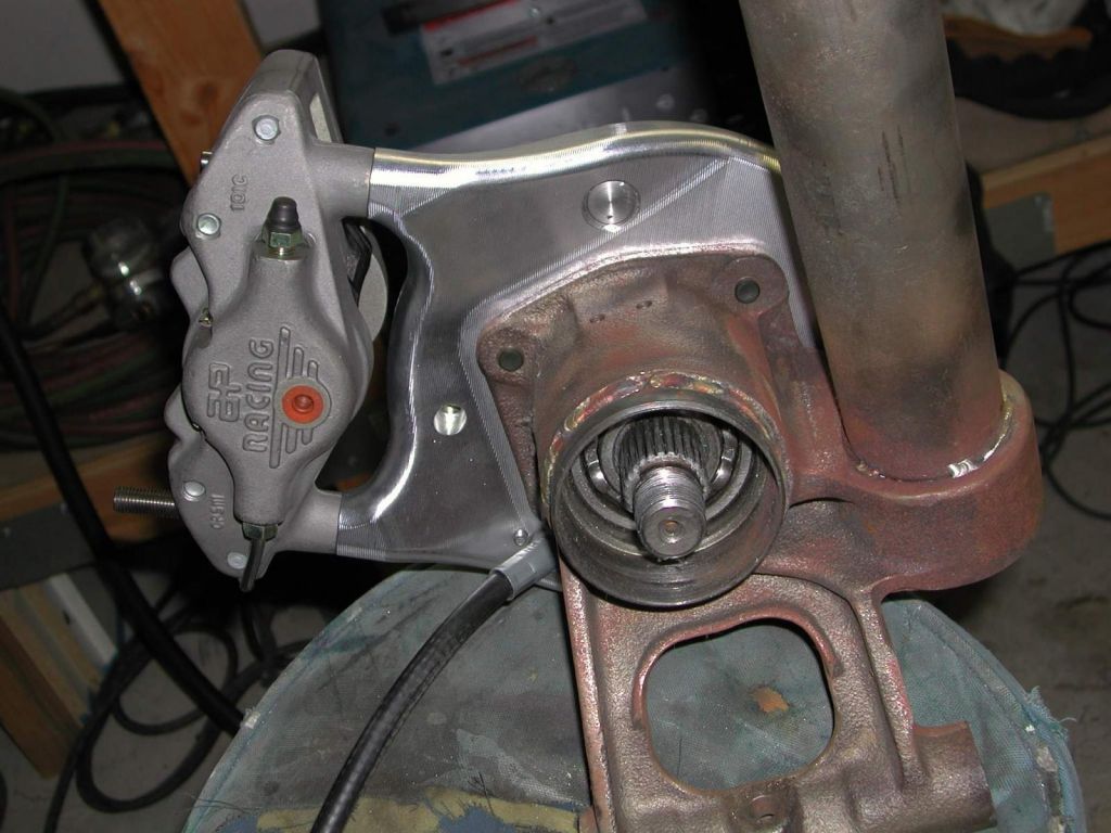

300zx turbo rear hub bearings 5 lug stub axle and componion flange, changed offset +20, custom backing plate using parking brake from a 94 300zx and rear rotor, AP 2 piston caliper CP 5000
