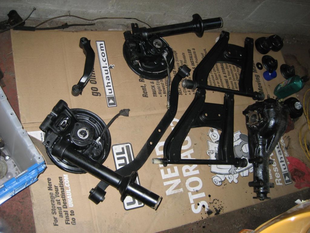

All the rear end stuff ready to go back up, and to recieve new Energy Suspension poly bushings. All parts, except for diff, were bead blasted. Diff and brake assmblies painted with POR 15. The other parts were painted w/ x2 coats of acid etch primer, x2 coats of Rustoleum and then x2 good coats of truck bed liner. The new shocks and springs will be from Tokico. New Brembo brake covers, rebuilt brake mechanism and new bearings in the rear
