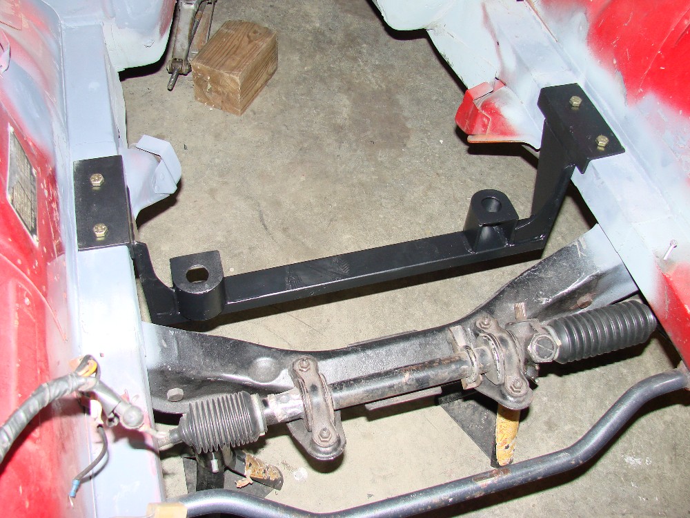

LS2 cross member
Pop N Wood
The starboard side motor mount is moved forward 2" to clear the JTR LS headers. Using S&P bisquit mounts. Wrapped frame rails with 18 guage and welded in 3/8 inch pipe spacers to mount bolts. Cross piece is 1" by 2", all steel 3/16 thick
