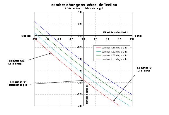

Camber_curves
74_5.0L_Z
These camber curves are for my rear suspension. The car has GC camber plates and is lowered such that the center of the LCA pivot is 7.125" above ground. The LCA pivots are the aluminum delrin bushing adjusted to give max negative camber.
