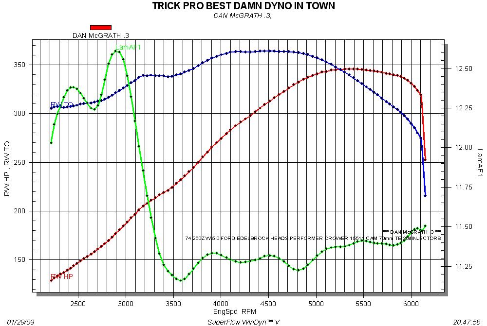

Dyno run of new engine.
74_5.0L_Z
Dyno run of new 327 Ford stroker bottom end. Edelbrock Performer 5.0 heads, Performer RPM intake, 30#/hr injectors, Crower 15511 cam, 70mm TB, 73mm MAF, 1.72 roller rocker arms, 10.3 to mahle pistons. No tuning just a break-in run.
