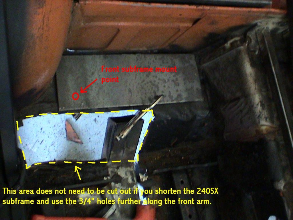

Front mount point for 240SX rear suspension
maichor
This view is from above and shows where you will need to reinforce the floor for a mounting point. I welded 1/8" plated over the existing floor and tied it into the frame I built that runs longitudinally along the car.
