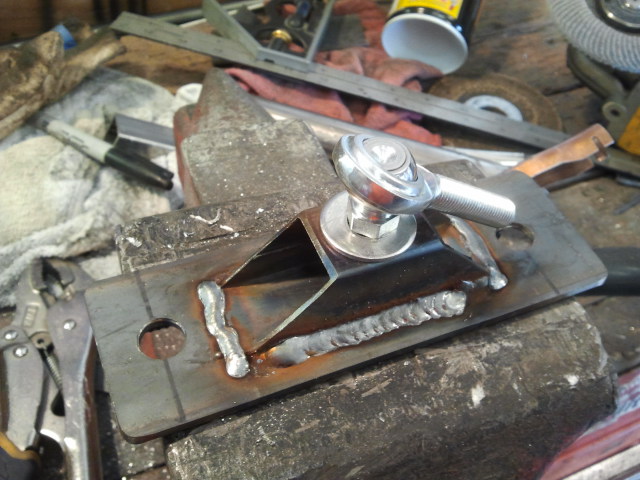

lower harness Bar mount Z
shuttlefever
Not sure if it is just a 2+2 thing, but the outer seat belt mounting point has an extra hole forward of the one that the seat belt was in. Same size mounting hardware works in that hole. So i built this mount to pick up both of those holes with this mount.
Harness bar
