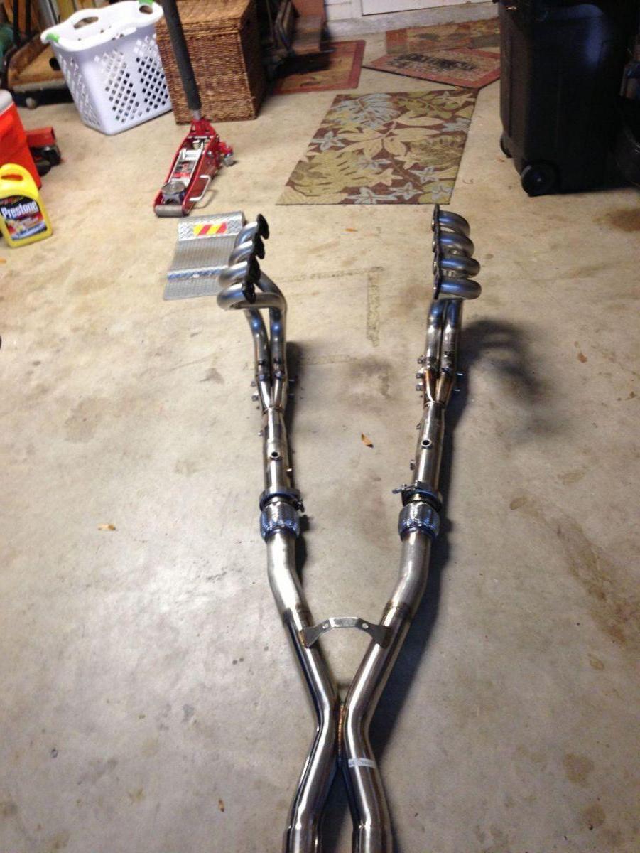

Top View showing the driver side and Passenger Side headers .
Headers are 18 gage 304 Stainless constructed from 1.75" mandrel bends. All bends use 2.5" centerline radius.
The slip on merge collectors, V-Band clamps, flexible couplers, and X-Pipe are shown.
