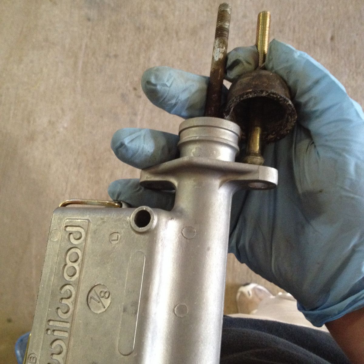

Swapping the master cylinder rod
BubbaDog127
Wilwood part #260-6765 7/8"bore
In order to use this, it's best to swap the rod from the original Z master cylinder so the length and thread will be correct for the clutch pedal attachment
