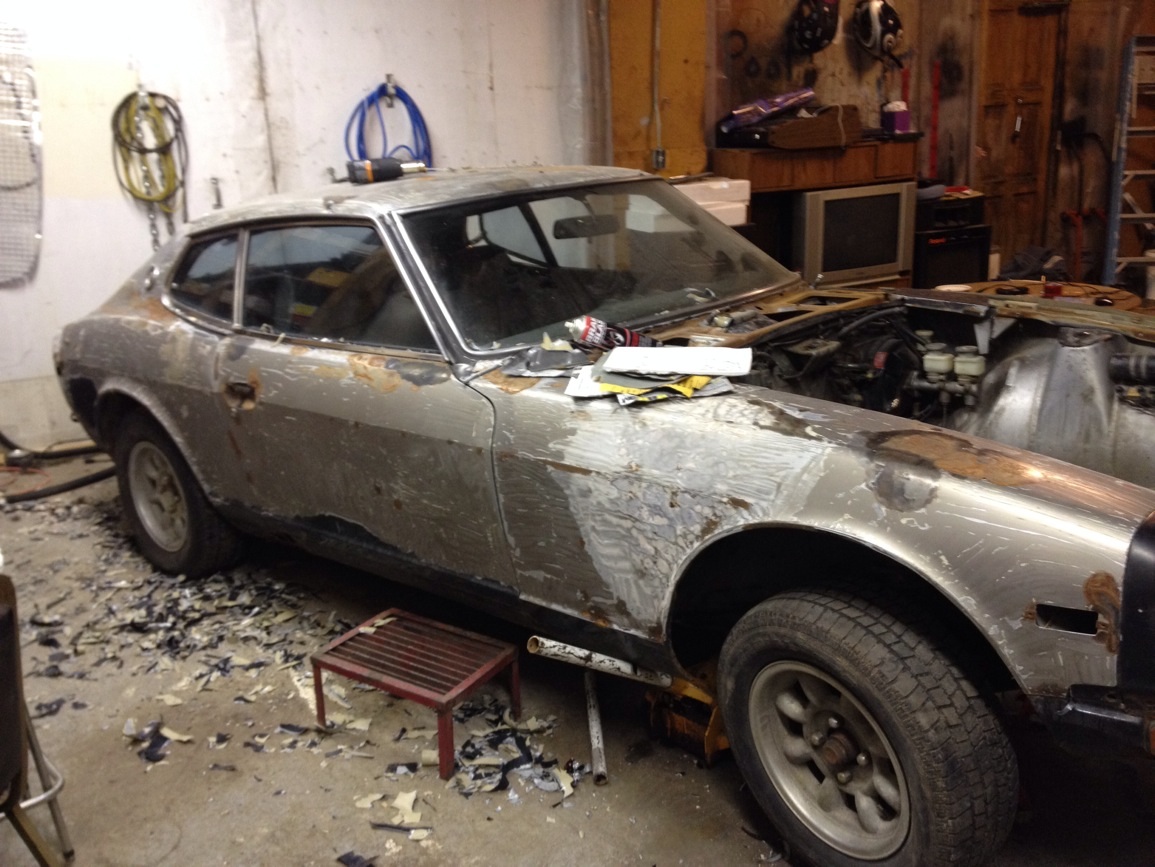

Right side mostly stripped
thebruce
Removed 99.6% of all paint with razor blade and heat gun. Very little mess, no fumes, without a doubt faster than using 80 grit and a 7" sander/polisher. Cuts through 1/4" of bondo like butter!
