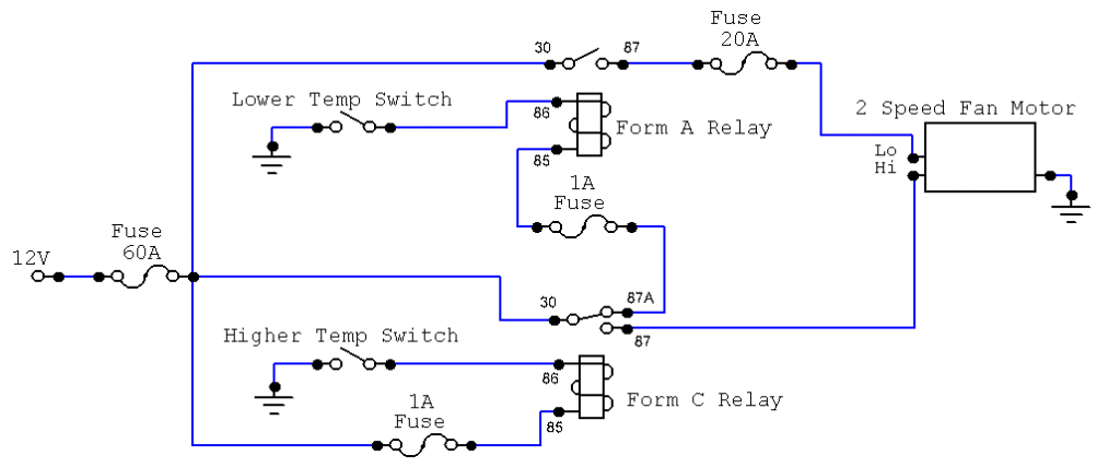

2spd fan control using 2 relays, 2 temp switches
pparaska
Like onovakind67 pointed out, if the high speed relay (Form C) fails, (and the term 30 to 87a connection is part of the failure) then this circuit would totally fail to turn on the fan in either speed.
