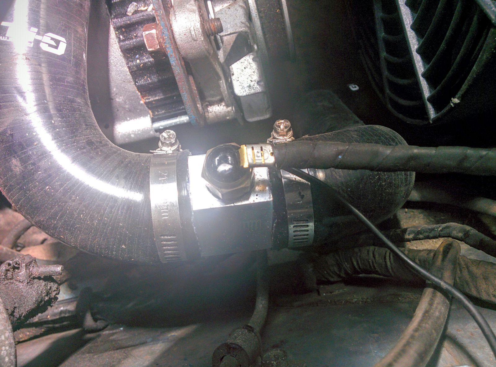

Thermostatic switch for the fans
Fabricated an adapter from universal temp gauge sensor adapter. Ended up putting the switch on the lower coolant hose. The switch is under the carbon canister for easy access. I also routed a wire from the switch to inside of car for a manual switch (relay ground wire like the thermostatic switch).
