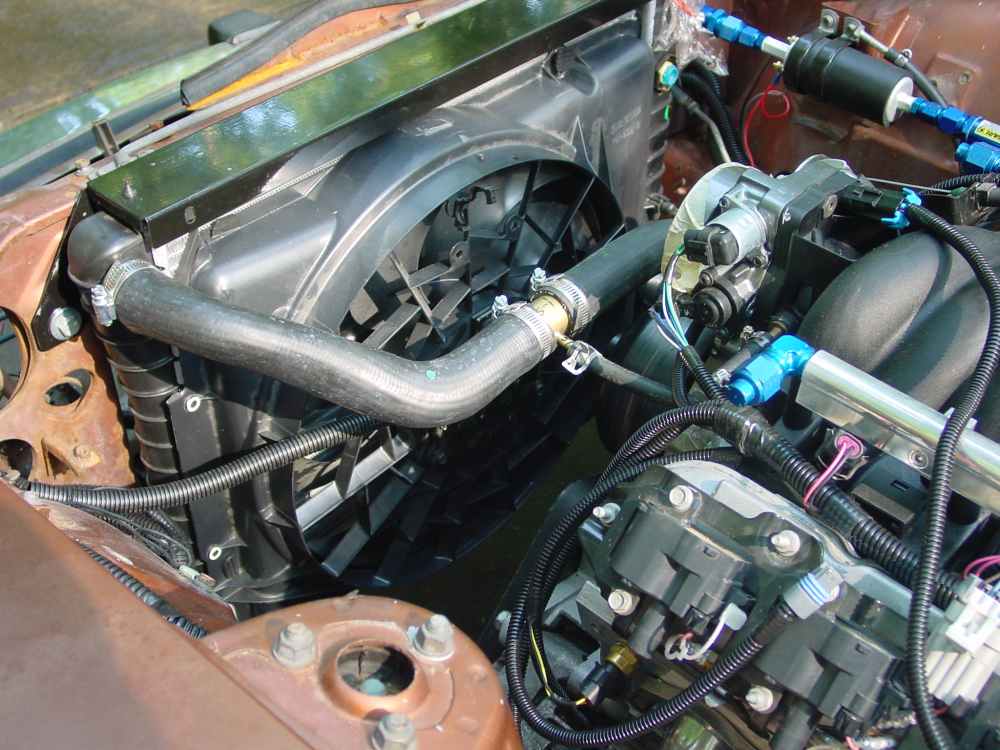

JTR LS1 hose adaptor for steam vent
This is how I ended up running the steam vent hose. I used and adaptor from JTR and spliced it into the stock LS1 hose.
