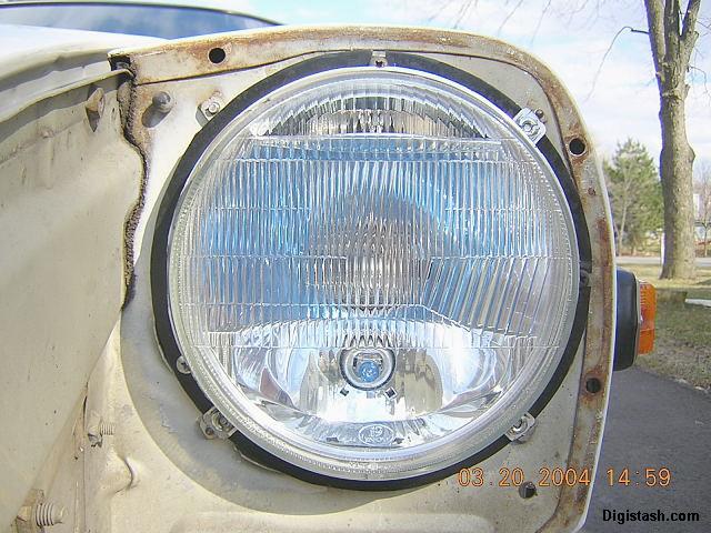

Turn signal, H4 headlight and H3 foglight in 7" case
I did this a few years ago. I got the headlights from Memo imports They're the euro style headlights for the Jetta... part# 1001HThe headlight bucket fits just fine, like stock. With the adaptor I made, you can even use the stock adjusters. The headlight throws off some awsome light and a great pattern. I believe the bulbs I got were the 80/100 watt from Memo. They look blue during the day, but at night the light is a very bright white light. When the car was running, people would always ask what headlights I had. The only problem with these lights are the turn signal, which was WAY to dim. So I installed 3 bright yellow LED's.To finish off the hybrid headlights, clear headlight covers make 'em look killer :mrgreen:
