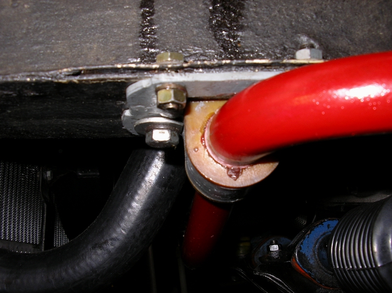

Modified Front Sway Bar Mount
260DET
A stronger aftermarket bracket with a piece of flat welded to it, two 6mm bolts go through holes drilled in it and the frame rail outer flange. The stock 8mm bolts remain.
