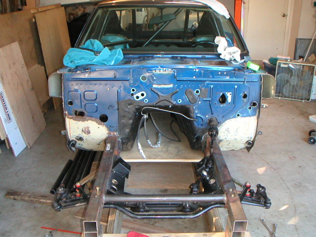

Car at its ugliest on the fixture
74_5.0L_Z
This photo shows the car after I cut off the original front end. The wooden structure holding the car was made to fit tightly betwee the original frame rails and extended back past to point "C" as shown on the factory frame drawings.
