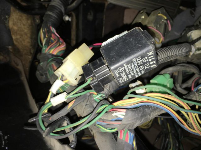

[quote name="Miles" Check your battery. The battery has 12.6 volts. I actually got it to crank. There's just no spark or fuel. Fuel pump relay doesn't click when turned to the on position and I don't hear the fuel pump priming. I still get that rapid clicking from that black relay near the steering column, which I don't know what it's for.
Thanks for the photo helps a lot. Now I still don't know where that other one goes.

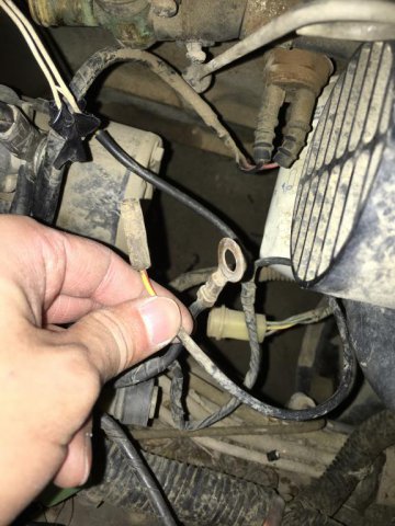

It does thanks, but I don't know why I have 3 wires coming out. I thought that black wire with the ring connector goes there too but it grounds my starter.

Also, this relay is constantly clicking when I attach the battery cable. I'll have to do some more research on what it is and what it's for.
Ok so I figured out why it was grounding. I had that black wire with the ring connector connected to the starter positive bolt. I removed it and I no longer ground the starter, but I have no idea where it goes. I also don't know where that yellow/red wire goes. Any help would be appreciated. Now the new issue is that I don't think I'm getting any power to the ecu. The green LED doesn't light up when on the on position. I can hear the fuel pump relay clicking when turning the ignition switch to the on position. The starter also doesn't want to fully crank the engine. I can hear it engaging and trying to turn the flywheel but that's it. I will try to have the starter tested at the local parts shop tomorrow.
