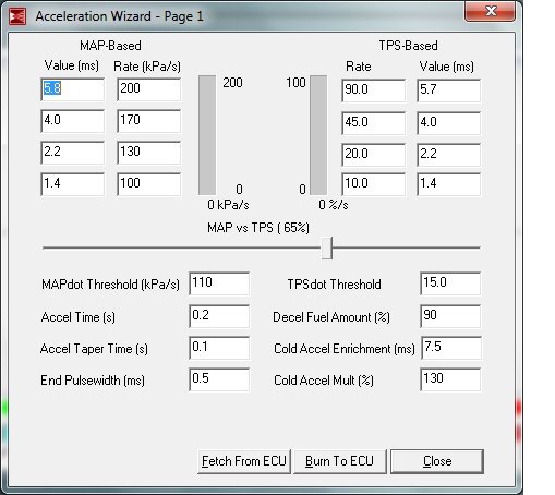

Here's my AE settings. more similar than i expected. i have it set to use some Map AE but i'm pretty sure it never enriches based on map for real. i keep meaning to switch to 100% TPS. -

Just wanted to grab some info from the megasquirt site and post it here since it seems applicable: "If the car does not buck under acceleration, you are close to correct settings. If it bucks and stumbles, then it is going too lean and you need to richen that part of the table. Before tuning decel [or accel], make sure you have your VE table close to correct first!" "You will have to go back and forth between the various accel setting to hone in on the optimal settings for your engine and driving style. Note that you should not use the EGO O2 sensor feedback to tune accel enrichments, this will only confuse your tuning efforts. " I did a lot of my AE tuning with the car not moving, just sitting in the driveway stomping on the gas at various rates like they say in the manual. Then drive around with it and take data and record the stumbles. Ignore the EGO reading as it says in the megamanual, but use the data to figure out what AE bin was used for that event so you can adjust it. I'll post my settings when I get a chance just for comparison but they seem generally close to the last post by Dan_Austin. i haven't changed them in years and they were good for my 2.8 and 3.1L motors. No hesitation or anything. -

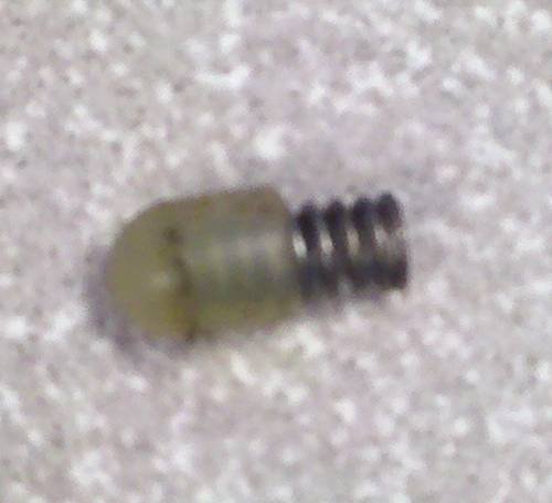

I'm looking for parts to repair my headlight portion of my combo switch. Inside the switch box section there are two plastic cups/nubs that pivot the metal switch elements. i need one of these plastic nubs. Obviously i could buy a whole switch, but why waste a good switch assy when i just want one nub out of it? Since i've seen people looking for working ones, chances are that bad ones are floating around. i need one of those bad ones with at least one good nub. I'll take a whole bad switch or just the nub itself. Any 240-280 switch should work. I've attached a pic of what i'm looking for in the end (spring not needed). The pic sucks but it's good enough if you've taken apart that part of the switch. Thanks in advance.
