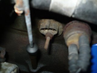

SO im trying to figure out what this sensor does/plugs into. Its on the left of the detonation sensor(the circle with two bullet connectors) this one looks kinda like a reverse CHTS plug, instead of going over the sensor it would plug into it. pretty sure its not for the Injector blower fan, thought its only plugs were to the ones in line with the radiator lines.. I know this is probably a crap shoot with out pictures so ill try and get one up soon.
