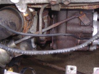

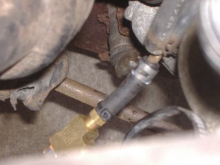

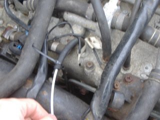

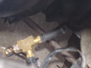

Alright got sometime to take some pics. I hooked the boost gague line up to one off the intake that feeds the vcm. It would idle around 18-20 vac. When i tested it out it would read 5-9ish psi when i would stomp on the gas, and when i wuld shift it would spike at 10+psi, which i know is not good for a stock motor(which ths is). Also when i let off the gas on that run it started to sputter/almost die so i feathered the gas and got it home, any ideas what it could've been? i haven't adjusted th boost controller at all so im thinking i hooked it up wrong but thats why im posting pics. I gotta ask someone that knows, is my wastegate acutator arm too rusted? cause it doesn't really move when i try to by hand.
