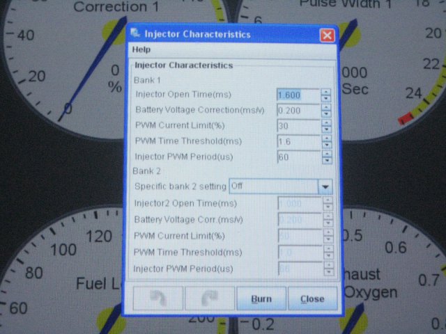

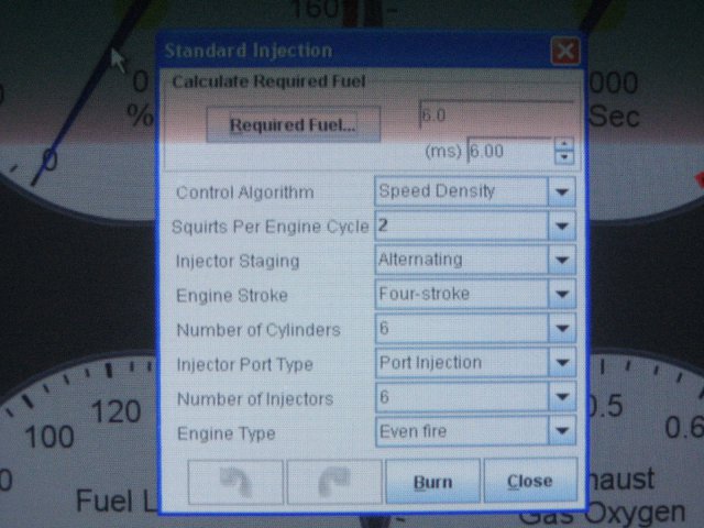

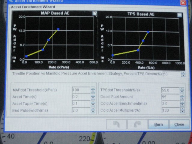

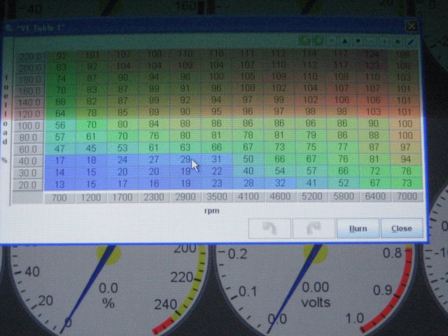

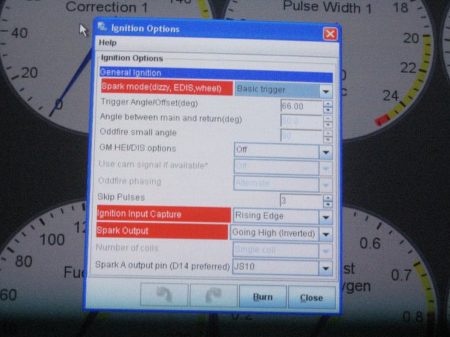

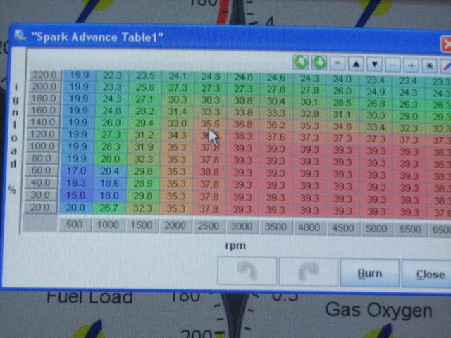

  3. Hi guys, this is my first post I believe, just thought I should give some back since this site has done so much for me, more than you can possibly imagine actually. My maps for ms2 msextra 2.1. My setup: 280zxt f54 block 50 thou over p90 head stock cam & head turbonetics 57 trim turbo 3" down pipe & exhaust volvo fmic fuel pressure at 40psi fidanza 11lb flywheel 5-6 lb boost This setup has my car running right now, pretty good actually, still needs some work but it runs strong for low boost levels. will post again when i feel it's better, still have to up the
