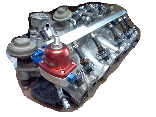

****UPDATE Continued**** JSK Fuel rail installed - new hoses/clamps. Replaced the blown up T3 - painted a few things while I was in there.
****UPDATE**** I realize I didn't came back to this thread to update anything. Here are some pics

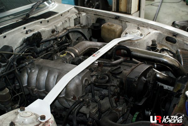

Has anyone had any experience with UR Strut bars? I like the look. Just wondering how good they are and if they will fit under the hood without cutting it. http://www.ultraracing.com.my/template.asp?menuid=56 http://www.ebay.com/itm/ULTRA-RACING-Front-Strut-Bar-for-Datsun-280ZX-79-83-UR-TW2-1340-/170808858378?pt=Motors_Car_Truck_Parts_Accessories&hash=item27c500570a&vxp=mtr#ht_4391wt_1206

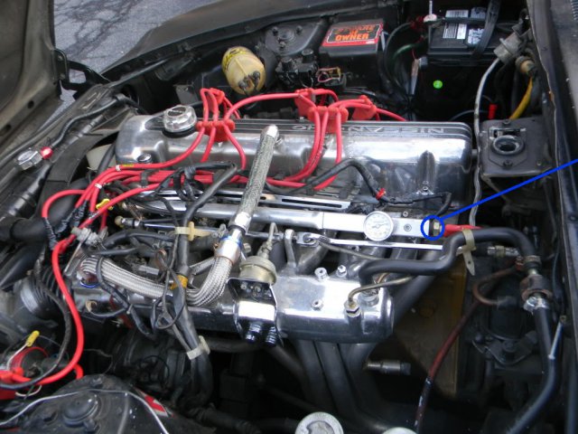

And you were 100% correct. Got my 3/8 NPT to -6AN adaptors ordered. I can't wait to get this installed along with my Fuel Labs pressure regulator.!
After looking at an NPT size chart that looks like its it. size| diameter | TPI | Pitch ---------------------------------------------- 3â„8 | 0.675 in | 18 | 0.05556 in (1.41122 mm) 0.675 in - which is why I couldn't tell exactly 5/8" or 3/4" diameter, its right in between. Thanks for the info guys. I'll check it out tonight after work and see for sure.
That would be a good guess. When I measure across the threaded opening it looks like 3/4". Guess I'll get a couple cheap NPT fittings from Lowes and test then order an NPT to AN adapter.
hmm. We'll that gives me more to think about. I guess my best bet is going to be to get a proper measuring tool. The barbed fitting(brass) all look to be NPT as is the Port the pressure gauge is install in. I got it used off ebay btw, thats why I'm unsure of the threading.
Does anyone know what size AN Fitting the ends on a barbed JSK Fuel rail are. I tried measuring the thread opening, couldn't quite tell exactly as all I had to measure with is a tape measure. It looked between 5/8" & 3/4" which according to wiki is -10an or -12an. http://en.wikipedia.org/wiki/AN_thread#cite_note-0. I have searched online and on the forums and haven't been able to find anything. I am going with a -6an setup so I'll need an AN reducer at the rail. Unfortunately I don't know of any shops/stores around here that sell AN fittings so I can't go test one out and get what I need. Though I did find a site with cheaper prices than earl - http://www.allpurposepipes.com This Fitting (Not my car)
