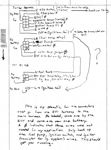

Hey guys the guy who started my swap cut the yellow and white wire, i have spliced them back together but i have no spark..... how can this be fixed? BumbbleZZ's writeup say not to cut it..... but its done now and i can't see why it can't be fixed?
This isn't even M.S. this is just stock ECU maybe in 10 or so years when my understanding of this wireing is better i will do M.S. One thing i still do not get is the conection for the ignitor guys, I have a blue wire and a brown wire attached to the clip for the ignitor. Yet the 83 wiring diagram calls for a YW and a BW the YW i found that on the E.C.C.S. harness and i have tapped in and run it to the ignitor, but what B/W wire are they talking about? Ignition? The one by the battery? can I even use to Stock n/a ignitor connector or should I go strip the turbo one, The guy who started this mess said it would be fine this way..... Thanks for all the help guys please keep it come'n i need it!
Thanks for the assistance, I still have a question though. I have figured out the yellow and white wire goes to the ignitor, The wiring diagram seems to say i need the black and white wire from the ignition on the other post. My stock ignitor connection has a blue wire, and a brown wire, what does the blue wire get hooked to???? i thin it should be the black and white just need confirmation. Thanks for the help and please do continue so frustrated with this thing (wishing for my n/a back)
I have used this site http://strausz.us/zcar/turboswap/ This way my model for my turbo swap, I think i may have gotten the wiring wrong does anyone have pics of where there turbo harness ties into the n/a Dash harness? What i did near the ECU was Turbo harness for (ECU) Yellow to ignition yellow with white to blue wire (from stock n/a setup off to the side single plug) Ecu power light lights but the ??Starter?? make a whining noise. The arrows and question mark indicates the connection i am unsure of, they both say coil so i tied them together..... Any help would be great (i am new to wiring) and i didn't start this project and i almost wish i had my good old n/a back so please any help is appreciated!
