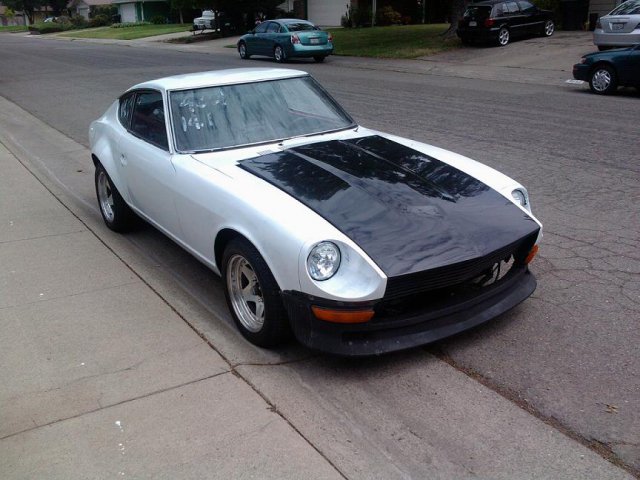

  7. Hi Guys! My name is Josh and I am in Sacramento, CA. I just picked up this 73 Z and it already has had an older Chevy 350 v8 swapped into it. I bought it locally off of Craigslist. specs: older 350 fuely heads with SS 2.02 valves 1:6 roller rockers Some kind of cam full 3" custom exhaust Accell HEI distributor single wire 100amp alternator built th350 trans w/shift kit and 2600rpm stall converter (which will be comming out next week in favor of a 5spd manual) the rear diff is not in the best of shape as I believe it to be a 180 that the PO welded up the gears in since he drag raced it often. I will most likely be looking to you folks on this board for rear end swapping info. I found a lot of helpful info on this site already!! I have swapped a few cars to 5spd already so this part I should be able to handle on my own. I also will be replacing the floorpans and some portions or the front subframe which has some rust issues. Also plan to get full coilovers and camber plates either from an s13 or DC2 integra. Here are a couple of pictures of the car a couple of days after I got it. I had to remove the hood and rediculously massive snorkel scoop that it came on the car. Also removed the drag car weld wheels and borrowed a set of wheels from a friend. I ordered aa set of the 17x9.5 Rota RBR in black and they should be here in the next couple of days. I have already replaced the OEM headlights with aftermarket h4 conversion cheapos and will be adding 8k HID units next week and am still waiting for my fender mount mirrors to get here from Thailand. I may also be replacing the engine mount plate that was used to mount the motor in the car since it looks janky and is only welded to sheetmetal. By the way does anyone know where I can buy replacement engine plate mount bushings to use until I make actual engine mounts and get rid of the plate all together? the ones in it right now look shot.

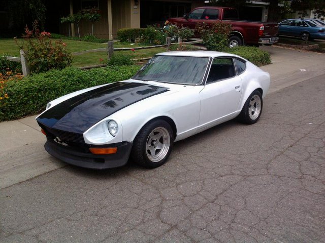

  8. Our cars look simular. I actually already ordered the same wheels (all four x9.5s though) which should be here in the next couple of days. hahaha you just stay in the bay and I will stay up here in Sac and we should be fine. LOL.jk Its a 73 with a 350/350 that I will be swapping to 5spd this weekend. I just bought it like a week ago from a guy here locally off of Craigslist. Has an older 350 with fuely heads, SS 2.02 valves, 1:6 roller rockers, cam, weiand intake, edelbrock carb, full 3" exhaust, homemade looking headers, built th350 with shift kit and 2600 stall converter, accel distributor. It moves but is not as fast as I think it could be. I don't know whats up but the engine plate looks janky so I have a lot of things to work on! They molded in the rear flares and failed to cut out the old metal fenders. Since the pics I lowered it a little and put 1 1/2" spacers in the rear making it a little more flush. I am going to most likley going to be doing the suspension next with s13 coilovers and T3 camber plates. I have always wanted one. Now I just need to start replacing the rusty floorboards and stuff. I think I will paint mine kind of a gold/greenish color. Here are a couple of pics of my Corona I sold to get this car. It just didn't have enough room for a v8 and parts for it were super hard to come by. Josh
