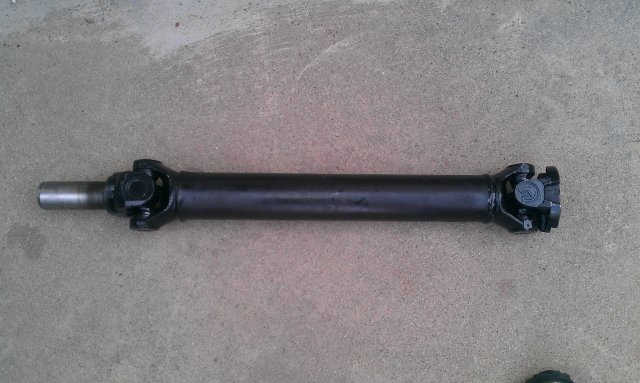

The drive-line was finished today. It came to about $68.00. He shortened, balanced and even installed the u-joints for me. The owner, Mike, was a very nice guy. I got it done at Drive Line Services in Fresno, CA. Here is their website. http://www.drive-lines.com/ -

Here is the u-joint I purchased today. This is the u-joint needed for a newer inner clip u-joint drive-line to fit the converter for the Datsun rear end which uses the older outer clip u-joint. From AutoZone the part number is 3-3130DL AutoZone website: http://www.autozone.com/autozone/parts/Duralast-U-Joint/_/N-6o242?itemIdentifier=217414_0_0_&newYmme=true not bad for $9.99 -

It's cool. Thanks for the link. It really helped a lot. Today I just picked up a drive-line. It is the newer style where the u-joints clip in the center but the rear end converter for the Chevy drive-line uses the older style that clip on the outside. I'm just going to look for a conversion u-joint. The book says a 92 - 95 Camaro with an aluminum drive-line has that conversion u-joint on it. I also found a shop local that will shorten and balance it for 69.99. I'm not sure if that's expensive but sounds good enough. After I get the clutch stuff in and installed and the drive-line shortened and installed it will be ready to drive. Well capable anyways. I'll need a exhaust system installed. Might be a little loud without it . Thanks for all the help guys. -
