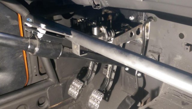

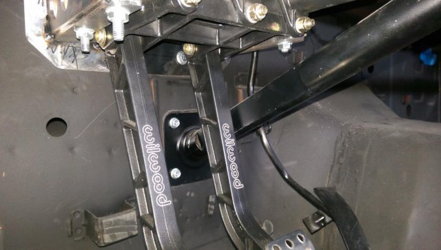

    In my last post I mentioned making a second bracket that attaches to the top mounting holes in the pedal assembly and bolts to stock tabs that the original pedal assembly mounted to. You can actually see the tabs directly above the master cylinders in the picture. I am choosing not to attach it to the rollcage. But you are correct, it is very flimsy at this point only being mounted to the firewall.

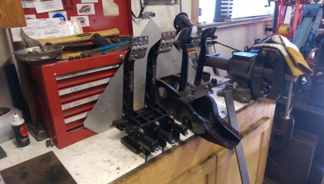

    I removed the collapsible section of the steering column and welded in a flat section in order to bring the brake pedal closer to the gas pedal as stock. The clutch pedal in turn is perfectly centered to stock location. I then mounted the foot pedal section as far right as possible. With the full cage I am guessing that if I ever need the steering column to collapse during an accident I have bigger problems. I actually did this mod years ago along with a very primitive pedal assembly mounting system. After revisiting the project years later I decided to redo the mount. I am glad that I did because I had the pedal assembly way too far forward. Not to mention the older I get the more patient I become. I am happy with the mount so hopefully it works well. Now I have to make a bracket to attach the top of the pedal assembly to the stock upper location.

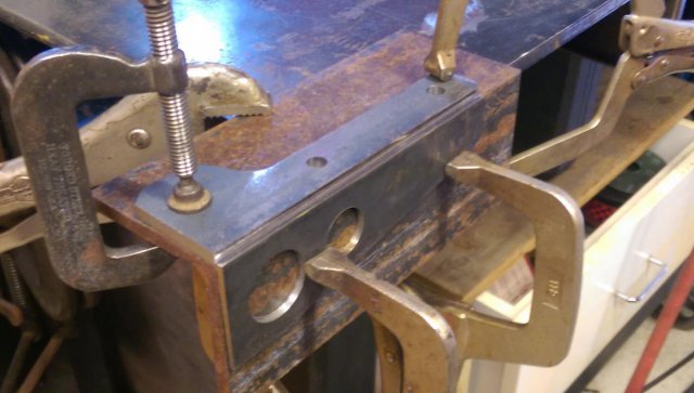

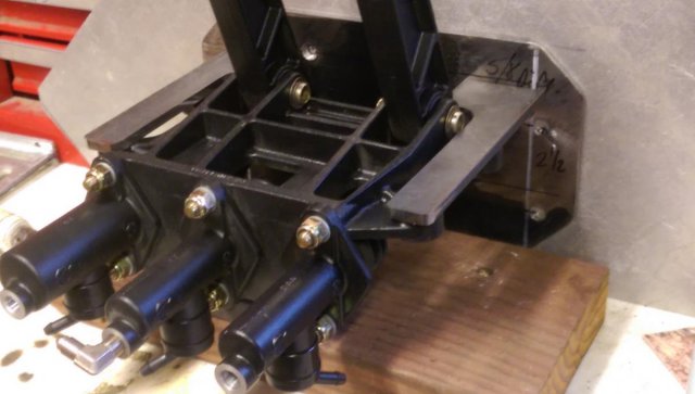

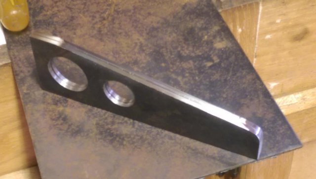

    Thanks for the replies. I built a mounting system that best matches the stock pedal location as it worked just fine for me. The pivot point is 2.5 in. away from firewall and center line came very close to stock location. I will try to attach some pics of the process. I will need to do some practicing before I weld them.
  10. Hello everyone I am currently installing a willwood brake pedal assembly in my 240. I did not get much info from willwood when I called except that the pivot point for the pedals must be a min. of 2" from the firewall. They said that pedal location should be determined by personal preference. I am shooting for matching pedal location to the stock pedal location. Has anyone done installed this pedal assemby? I would appreciate any advice. Thank you
