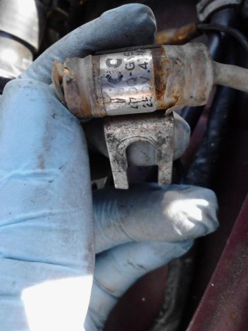

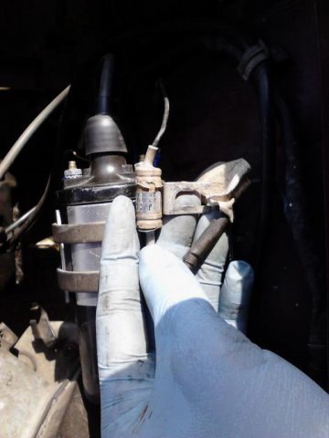

1978 280z I am trying to find what is causing this. The motor starts and runs almost flawlessly. Then at times, without warning, it will stall, usually while in motion, a couple times while idling. This is completely sporadic in that it may go days, weeks, even a month without repeating. No warning, just a quick jerk followed compete loss of power for a brief moment that lasts half a second, 3-7 seconds, then another jerk and running fine again. Most recently it when it started raining heavy i had no spark for 40 mins. I know I have fuel, fuel pressure, so the problem is spark. I am thinking it is ignition related because I don't notice any disruption of power with radio, wipers or other electronics. While looking for clues I found this, mounted next to ignition coil. Looks beat up. What is this, will it cause these symptoms, and where can I get another?
