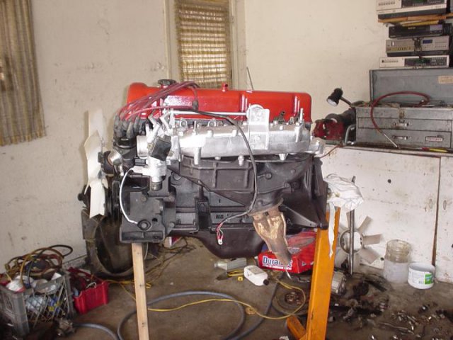

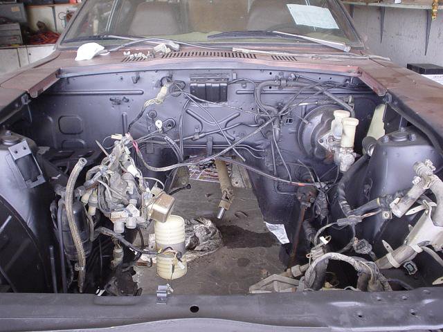

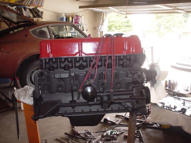

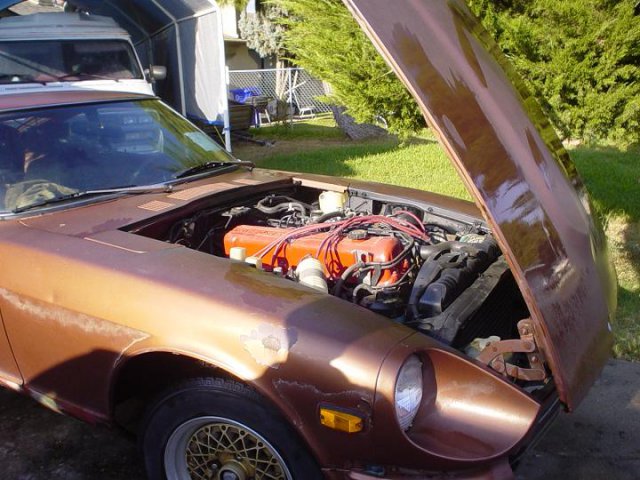

OK here goes.... done with my L28 NA engine got it in the car already... It is a N42 Block with an N42 Head. Converted the auto tranny to a manual from a manual 1980 280zx donor car. From the 280ZX I have a N42 Block and a N47 Head. this is my question, I would like to use either the motor i have in the car now to add a turbo (and yes I did a lot of research on engine managment and what head to use) but it has been done with this block. I guess the whole issue is can the N47 Head be built up to with stand a turbo build up or should I go with the N42. I know I would have to aquire the Turbo and the Manifold, intercooler, bigger injectors and so on but I would really like to build up the N42 Block with the N47 head because I have a car that needs to be smoged every two years and my plan was to swap out engines from mod to NA then back to mod engine after the smog check. I have all the tools the engine hoist and the can do, its just the build of the mototr and the electrical wireing. now with the turbo If i do not change out the computer can i just do a stand alone with a megasquirt with the bigger injectors so when i do the swap back to the NA motor than I don't have to much to worry about electrical. also with the piping i will fab it so that I can remove it when I do the NA swap.
ok so
1. can I do the stand alone megasquirt for the fuel management so I dont have to mess with the electrical.
2. The build up on the N47 head..good or not good..
3. most important question is can I make this conversion good enough to make it a smog legal turbo engine so I don't have to keep doing the swap.
I know alot of you guys will say just get the donor car with turbo already and just swap it out but believe me i have looked and nada.. so my other option is to do this. all advices will help me out big time.. thank you guys in advance.
