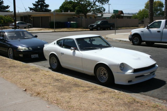

So I stripped my honda and sold all the parts to buy my Z. The owner told me there was a few issues I needed to deal with on the car. I noticed while trying to fill up after a certain amount the car will leak a good amount of fuel from under the tank. Filler hose cracked?
Another issue are the brakes. There is pretty much no pressure in the brake pedal. The fluids in the reservoirs are pretty low. I have to bottom out the pedal and use my ebrake together to stop the car. Very scary. Where should I start? Fill the resevoirs up and bleed the brakes? Im worried the brake booster is out because it doesnt build pressure when the engine is off.
The car doesnt have keys installed on the doors.He did however give me new locks with a key. How difficult are these to install? Im sure ill figure it out once I remove the panal but Id like a general idea of what goes on in there.
Any direction or advice is appreciated. thanks
