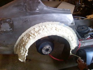

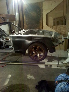

One off custum fender flares, let me know what you think!
spudly13 replied to spudly13's topic in Body Kits & Paint

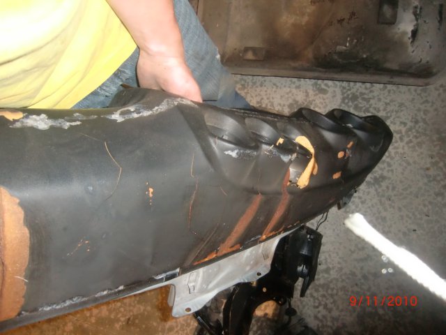

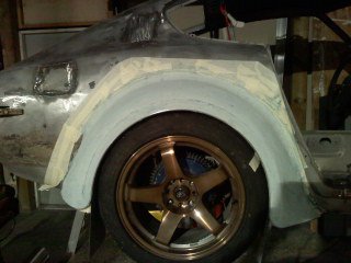

I used sheet metal as the base, then spray foam to get it into a rough shape, from there bondo for final sculpting and now im using it as a mold to lay fiberglass on and make the flares. The fronts were basically the same, the major difference is the fronts are a full fiberglass fender. -

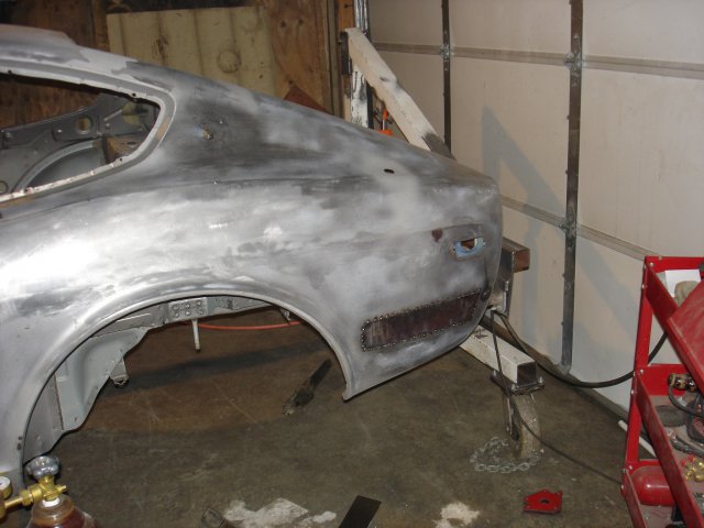

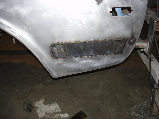

I just recently filled mine. I found a donar roof just like yours, Cut out the majority of the roof pannel. Held it in from the bottom lining it up perfect and tracing out the whole. Cut the piece a little big so i could trim to fit. Once i fit it and was happy i tacked it in and kept going around with tacks and grinding until it was completely filled. Afterward i had to go around with a hammer and dolly to smooth some areas out. But overall i was happy with how well it worked. Note. Be extremely careful not to put to much heat in one spot. It warps and bubbles really really easy.

Im gunna look into those fenders a little bit more. There sorta spendy but it would make my life a whole lot easier when it came to all that body work. Thanks a lot for the help!!! 12in tires would be amazing to get stuffed under my car. i still havent fully decided what type of tire to go with quite yet. I was thinking slicks for awhile but then the car would be no fun to drive except in a straight line.
Ya i do really like that look. The cars gunna be a fair weather driver and will have a full cage... i plan on tracking it a little bit. Thats the main reason i was looking at wider flares.. to help cover up a really wide tire (tt 350 = lots of power and little traction).
That looks pretty good. In the end i think i want wider flares and was going to modify whatever flares i ended up with but if it looked that clean in the end i would be happy. How hard was it to mold the airdam into the flares? And do you have any pictures of that process? Thanks
Thanks for the help guys. Seeing those pictures really helped me figure out how im gunna go about doing this. Even tho it was in japanese haha. I think im going to use this air dam http://www.thezstore.com/page/TZS/PROD/7AD1/50-1439 And ZG wide flares And get it all molded into the desired look. (my flares will completely molded into the car, no bolt holes or seam) What do you guys think? Thanks again

Spent the last few weeks re-organizing our shop so i havent been able to get any work done.... BUT!!!! In the last few days i started up again. Were starting on motor and tranny mounts, floor pans, and a bunch of metal working, filling, and rust repair, FUN FUN!!!

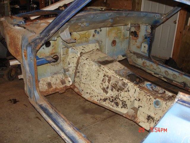

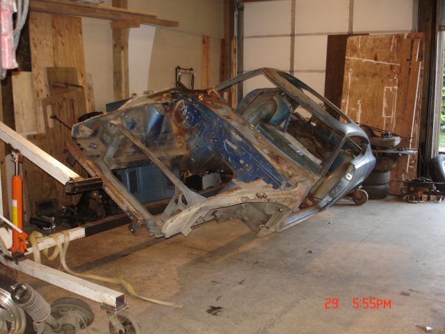

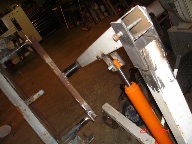

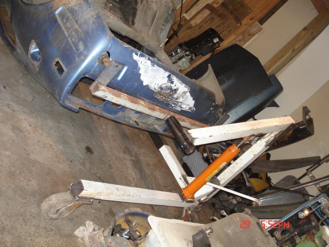

We were able to build it for about 175 bucks 50$ per jack and some steel. But we also had a bunch of scrap steel lying around. You could probally build one for a few hundred dollars and have a nice functional roticery.

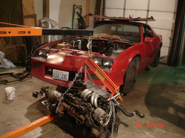

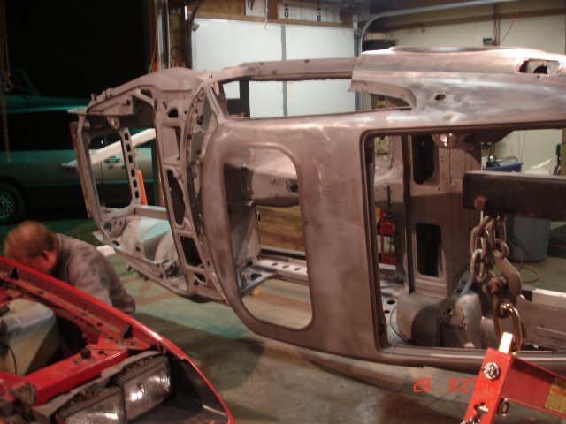

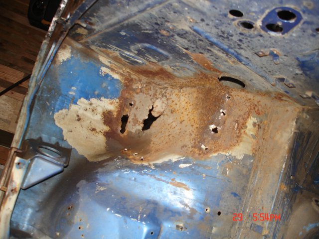

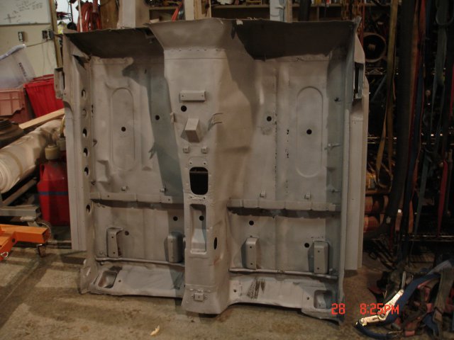

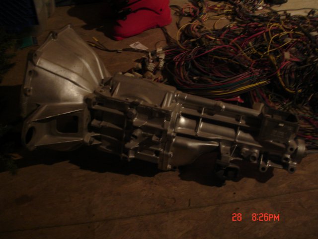

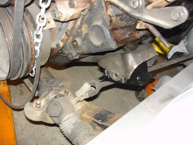

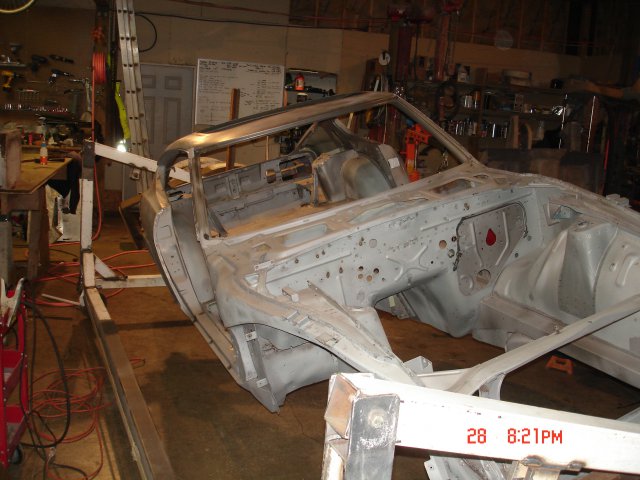

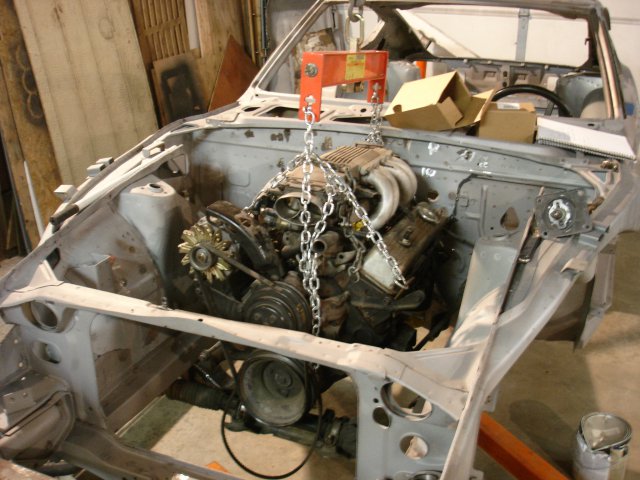

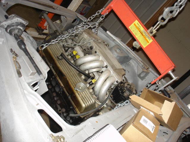

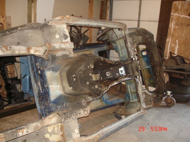

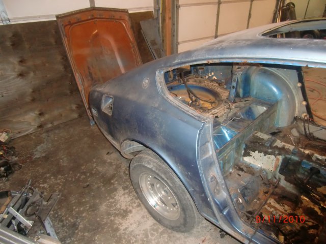

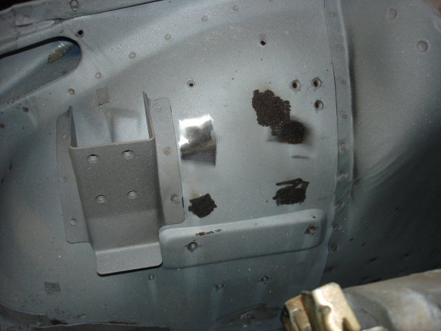

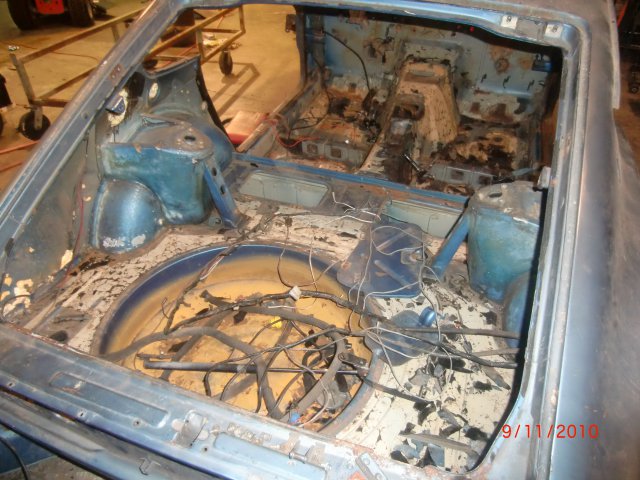

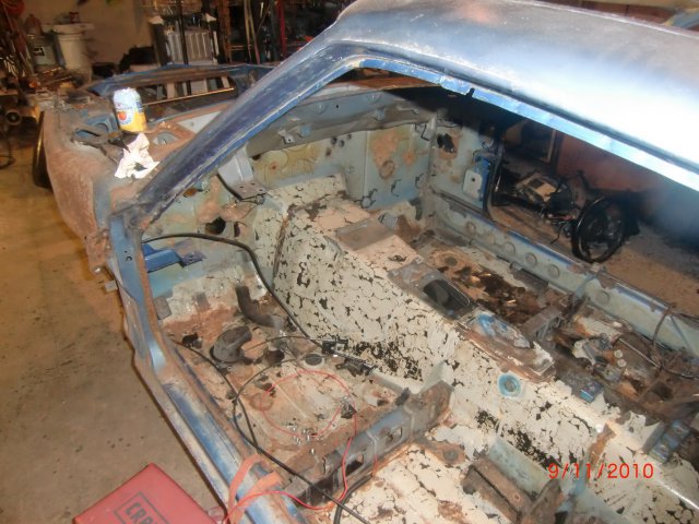

I havent posted anything for a few weeks. But a lot happened in the last couple days. 1) I purchased my brand new transmission. (t5) for now... cant afford a t56 yet 2) I got my car back from the sandblaster (Tons of rust and 500 Dollars later) 3) I pulled my motor out of my donor car (tpi 350) 4) I scored an entire floor piece rust free for 60 bucks! (my pans were wasted and it beats a few hundred for new.)

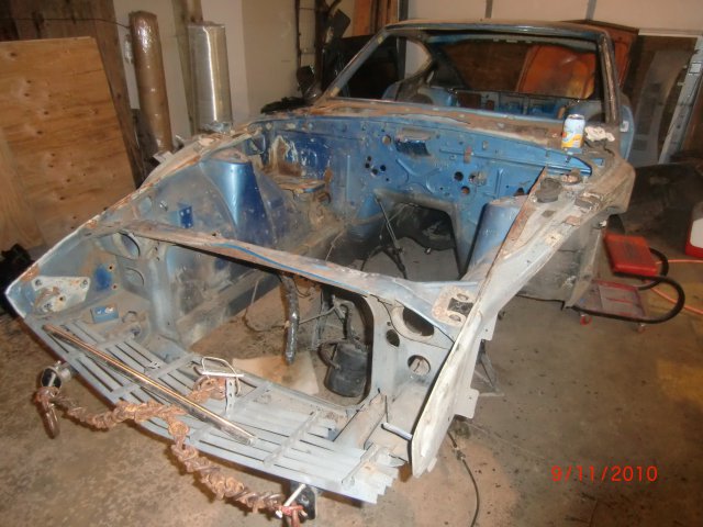

Just bought my seats. Found them on craigslist for 120 bucks. There leather but extremely comfortable Car went out for blasting today!

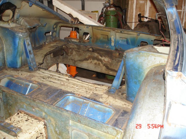

Just thought id post some pictures of my 74 260z project and get some feedback. We just finished building my roticery and the car is going to be blasted next week. Im putting a tpi 350 and a 6 speed in it. Im only sixteen and this is my first ever car build so let me know what you think!Constructive criticsm and ideas would be much appreciated! I may only be 16 but keep in mind im paying for this whole build!haha Any good ideas on rearends? Suspension? Roll cage and stiffening? Rear disk conversion? Thanks
