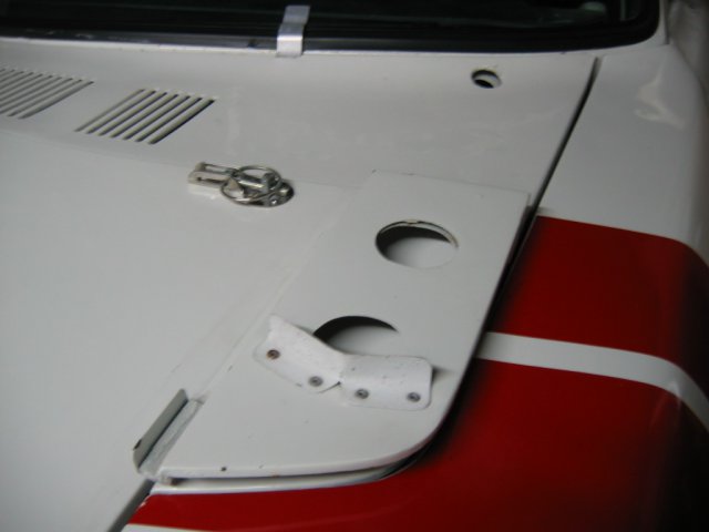

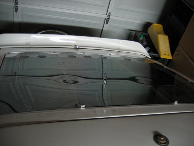

  1. Thanks for the replys, guys. The lip in front of the exhaust holes seemed to work. I string tested the right side without the lip and the left side with it. The side without the lip had strings moving in and out of the vent holes, the side with lip always flowed air out of the holes. Just about anything on the upper surface of a wing will decrease lift, I like the idea of the "safety" third brake light. The nose is my biggest problem, and I'm planning a complete refab with ideas gleened from the air tunnel data. Once my vintage legal Spook spoiler mod is complete, I'll do another round of testing.

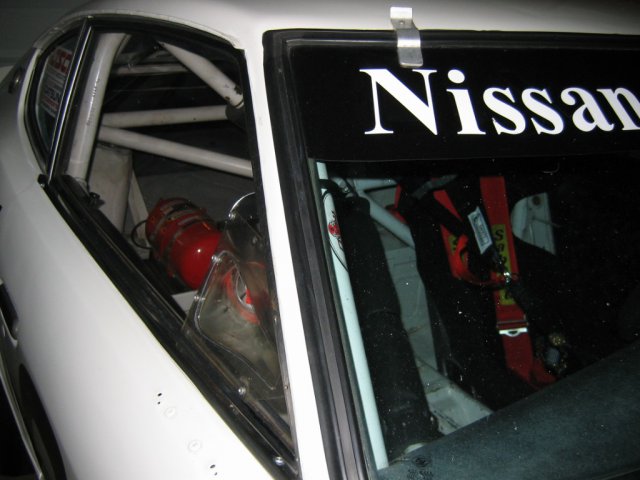

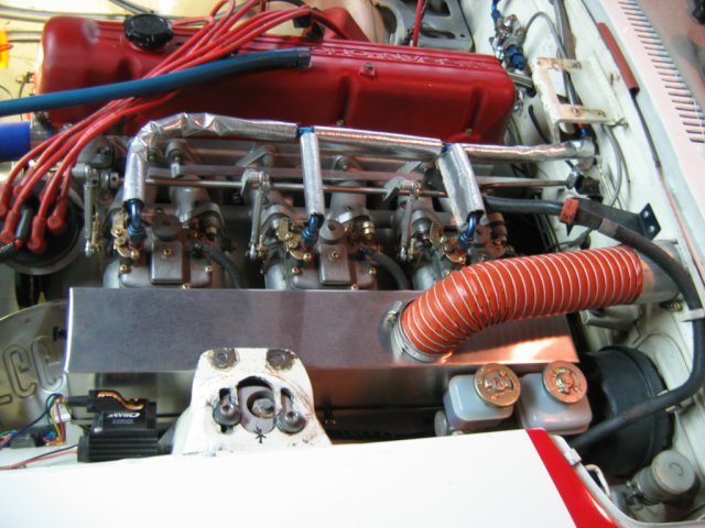

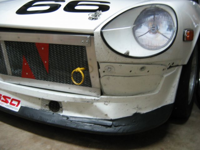

  2. I wish I would have come across these threads some time ago. I have been string testing my mods at the track for awhile, some have worked, some haven't. I have to stay vintage legal, so mods must be "subtle". Vertical rails trimmed for aero drag, but horiz ones left for aero stab; front/rear windshield "support tabs" with just a "little" left over; underhood air evac vents with tab (tested very well); frontal area reduction grill with rad support/hood blockers; passenger side plexi with NACA; NASCAR style airbox. More to come...
