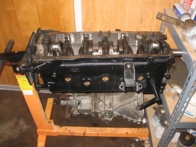

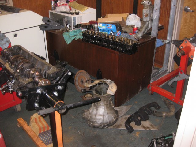

more pic for ya....i gotta run get some bolts for the cam towers but she is moving along nicely. still gotta time it and put the rockers in.

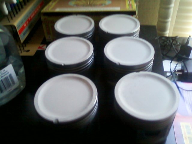

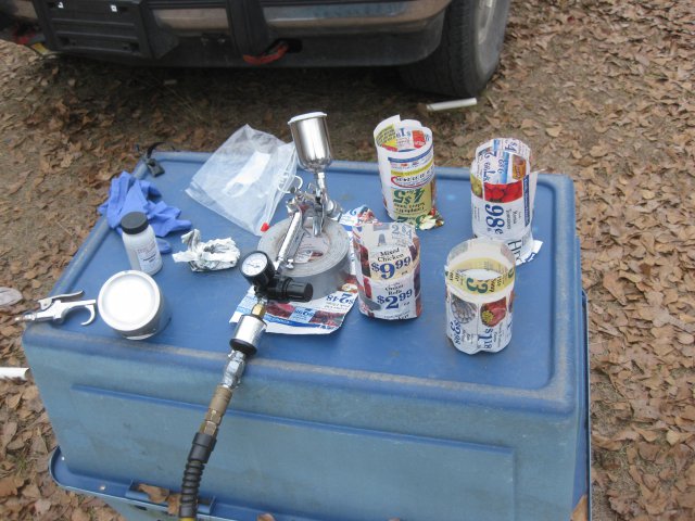

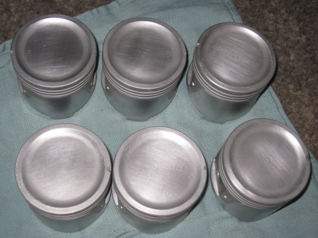

baked on at 350 for one hour after the part reached target temp. i went all out on coating the pistons because i got them for 16$ bucks without a wrist pin. i had a few laying around and some extra cash so i got a toaster oven off ebay and took it from there. they are some really good coatings just be sure to pre-bake and clean old parts or just clean new parts with acetone. The dry film lube will buff off with time from friction but it will be baked into the metal and stay around for a while.

and to answer any questions about the pistons they are coated with tech line coatings dry film lube on skirts and cerma-coat on the tops

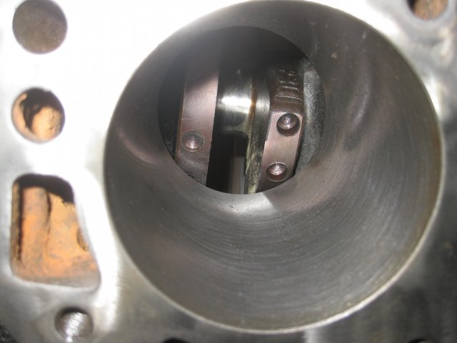

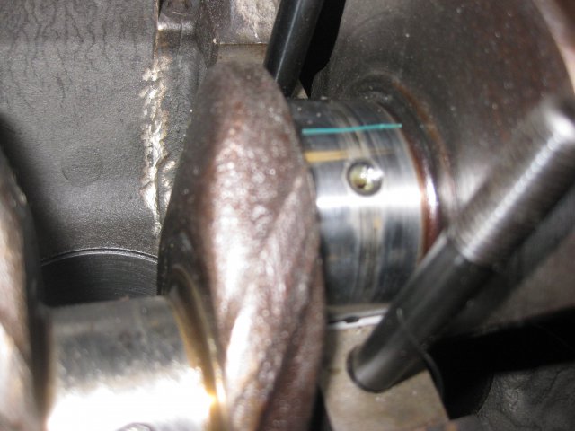

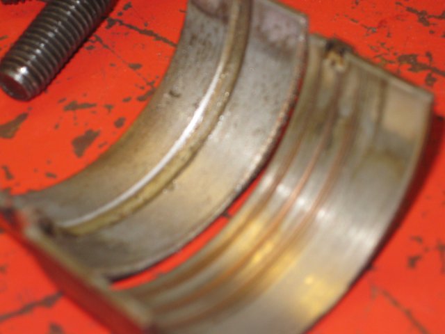

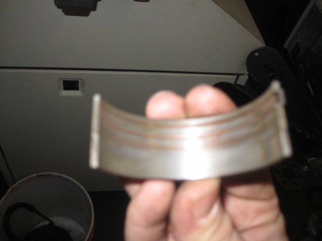

i got a call from my machine shop and he said i was a little under size on my rods. maybe i should try running some thicker oil or higher oil pressure. I am thinking of doing both.... so my question is how can i get the higher oil pressure??
